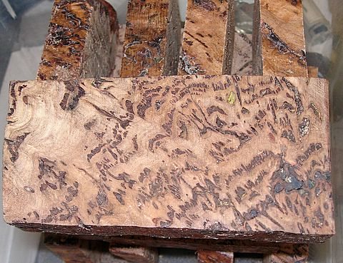

Is anyone here experienced with ERB? I bought a slab of it and now that I've cut it into pen sized slabs (thickness), I am not quite sure how to use it. Should it be stabilized? Or do most folks use filler for the crevises? It is quite unique and I would hate to waste it. Here's a pic:

I haven't turned it although I would like to. I would not think it would have to be stabilized being Eucalyptus but I am not sure about the ERB. Can't wait to see a pen!
Rob, if you send me your stash, I'll be happy to test it out for you on a few dozen pens and see whether it needs to be stabilized.
Stabilizing isnt needed and wont do much to hold the resin pockets in either. Best bet is CA the pockets until they wont take anymore and then turn. As you turn it down you will have to fill voids to keep it from coming apart. They are a lot of work, but really cool looking when done.

Jim, you are so generous, but some kindhearted soul already offered to help me out and I sent it all to him. Just kidding. Anyway, as it already seems dry, it won't be too awfully long before I put it up (for sale). If I can turn it, anyone can. It will be part of the burl special. I'm still awaiting the return of my stabilizing test, before I can send out a huge order. I won't be stabilizing this stuff, though (thanks to Scott's and others' advise).
I think I'll try some brown mallee and some of this ERB in a couple of pens. If you hear me yelling from your house, just ignore me. This stuff looks like it will get under my skin pretty easily. I'm going to try some bloodwood, mixed with epoxy to fill the holes, when I get the blank round. I think I'll douse it first, to hold the blank together.

I live in Victoria, Australia where this timber comes from. It's called "whitetop" and is from high mountain country near the snow line. I filled the crevices with CA glue before turning the wood and then added CA glue is it got closer to the finished size. It won't break apart as someone else suggested. It makes very organic looking pens. Kim Strode

I'm still learning. CA the blank when you get it mounted, like what was stated earlier, then more when you get 1/2 way, and again, with a filler. I didn't do a great job on this pen, especially with the CB (bloodwood). Photography (especially the flash) wasn't very good either, but my wife loved it, so it's hers now.
