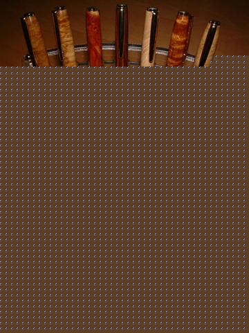

I love turning eucalyptus. Just make sure its dry enough when you turn it. The twisted grain and color changes in the wood are great. Turns well and looks great finished. Check out the third one from the left.
