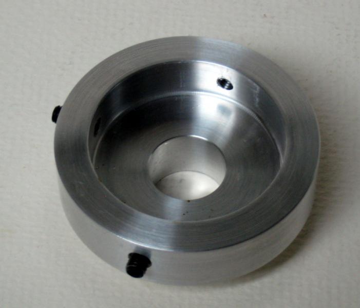

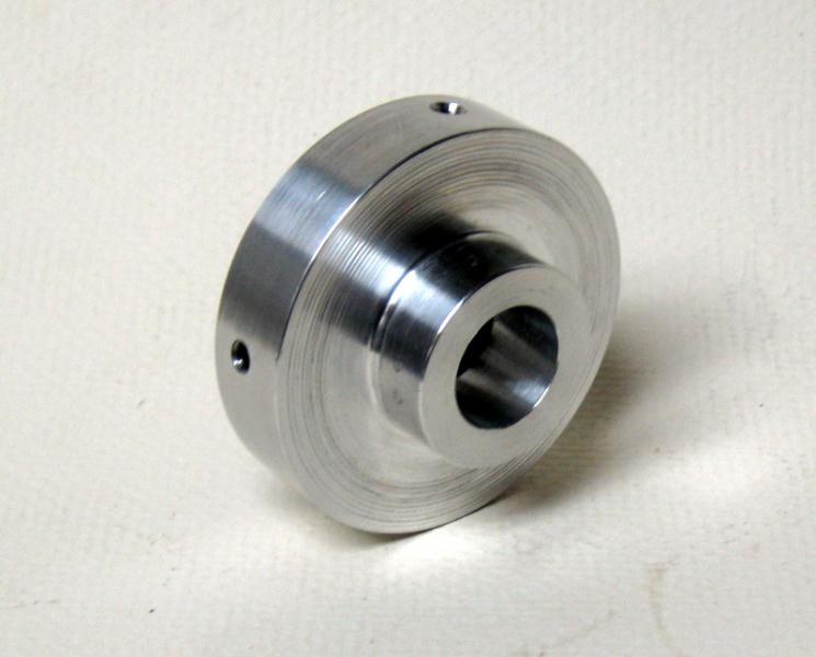

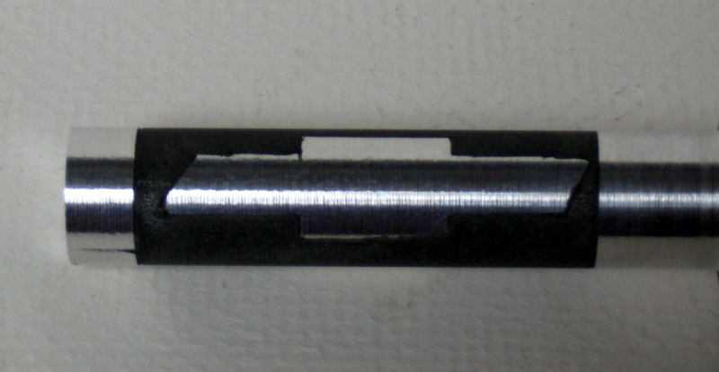

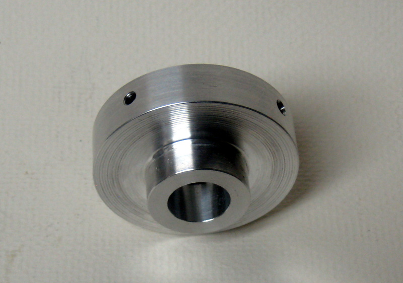

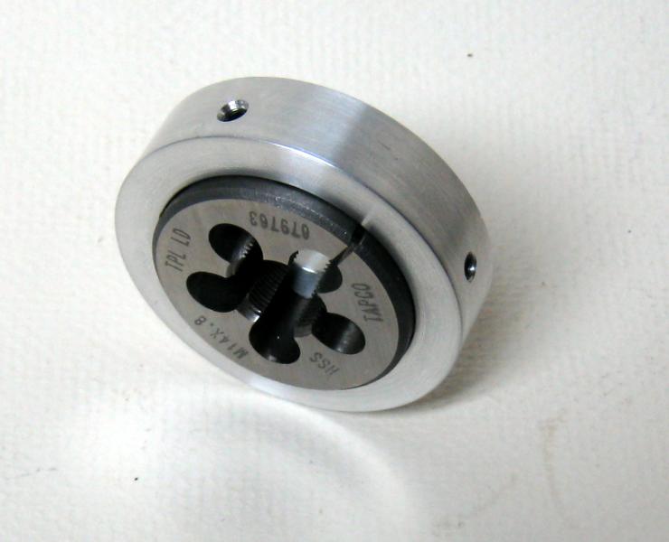

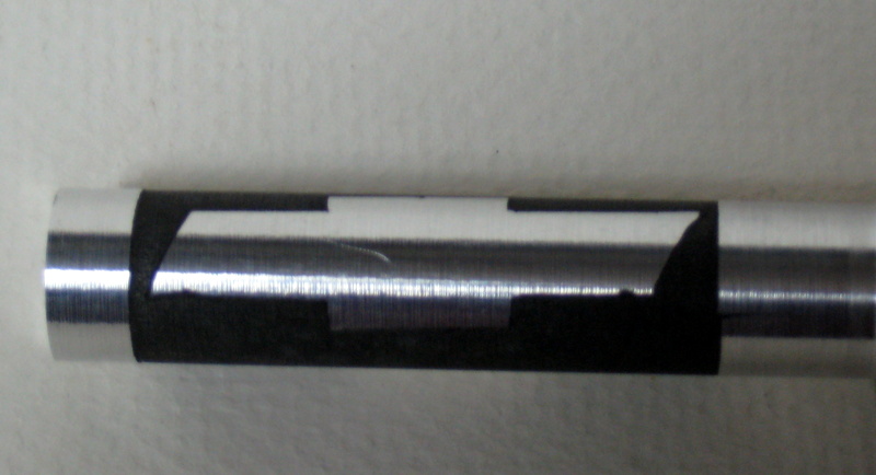

Had a great day at Mike Rouxs(Bluwolf) house today. First off, when I got there, Marshall (Mapster) was turning an adapter for my die holder. He was doing so well, I decided not to interrupt :biggrin: Mike Roux finished it, by boring it out, drilling holes, tapping and overall finishing it. Thanks Mike & Marshall. THEN, we all got a piece of aluminum, drew some designs on adhesive vinyl, and stuck them on the aluminum blanks. Dipped them in the sauce, that Mike Redburn(Mredburn) brought, along with his hot plate for heating the water. Thanks Mike! Then washed them off. Thanks to BradG for showing this can be done. Hopefully, the two Mikes & Marshall will post some pictures of theirs soon. Mine is a little rough around the edges(literally) where I got a little too aggressive with the paper towel, after soaking in hot water then when I dipped it in the chloride, it got underneath the vinyl in a couple of places. Great day in my estimation. BTW, my design is a CHEVY BowTie :wink:

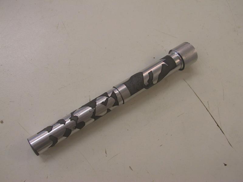

Considering we were winging it I thought we did just fine. Mike Roux picked up some sign vinyl and we hand cut out our designs, I brought a couple qts of "Brads Swamp Sauce" for the etching. Marshall and Mike Roux had the best luck with the etching process. Very fun day over all. I even got to borrow Chuck"s supervisory chair he brought for just the occasion

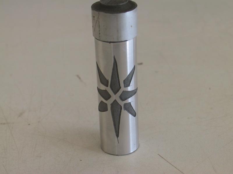

Yeah, we had a lot of fun just screwing around with it. I did mine a little different. I wrapped the rod with the vinyl then cut it out on the rod. Mine is the one with the little star kinda thing on it. You can see where the razor knife slipped at a few edges. It also etched deeper around the edges, we think because I scored the aluminum while I was cutting it out.

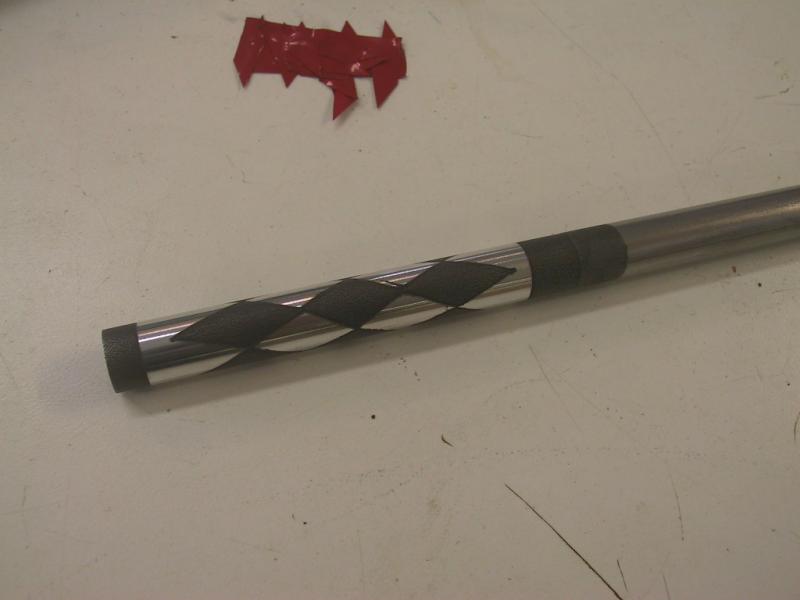

I grabbed a a couple of pictures of Mike's and Marshall attempts too. As you can see from the group photo, it was a highly scientific and organized experiment:biggrin:

We all showed up without the first clue as to what we would do for designs. We literally just drew something cut it out and went for it. Mine turned out crappy as my skills with the knife sucked. But the event was to try it and be able to hold it in your hands and really see what happens. Its really instant gratification. Unlike anodizing which takes 2 hours to see if you have an acceptable results this is 5 minutes or less. We did dip the aluminum and vinyl stickers in very hot water. We used duct tape to mask off the top where we held the blank. We duct taped a string on to them for dipping. Marshal just held his whole rod of aluminum in the solution and then cut it off later. We did not heat the solution but we did time the dipping. Mike Roux I believe had 5 minutes on his Marshall and I about 3 minutes on ours. Since I had a lot of "Brads Swamp juice" I gave both Mike Roux and Chuck a quart or so apiece and I will make a new batch for me. That way they could play at their leisure at home.
