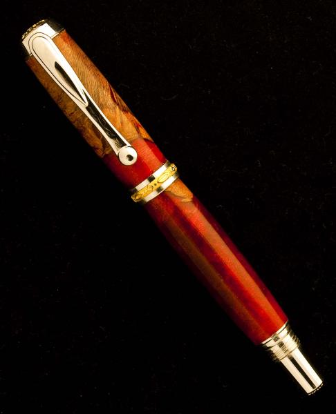

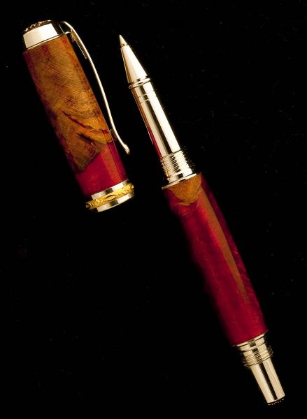

I took a break from pen making until my shoulder quit hurting. Finally decided to start again this morning with Curtis's creation in his "Worthless Wood" Series. The blank is an Escarpment Black Cherry and pen is a Jr. Statesman.
Sanded to 600 grit. Medium CA X 10 coats. Back to 600 grit, cross-sanded and then Micro Mesh wet to 12000 grit. Finished with HUT plastic polish and Ren Wax. Any comments welcome and thank you for looking.

I'm look'n and really like'n. That is a beautiful pen. I'm going to become a WW convert yet! I think the ones with the red combo are my favorite.

Scott, I didn't paint the tubes...I painted the inside of the blank with Testor's
red paint and a q-tip prior to inserting the sanded tubes. Doc

Nice Finish! Good job on the "back painting" the blank! It looks great. I hope one day I can get my finish as well as that. Shawn
Shawn.. I used the "back painting" technique you told me about as well as the CA finishing technique ...:smile:.. and by the way, I have seen your finishes.. up close...:wink:and they are every bit as nice or nicer. Doc
