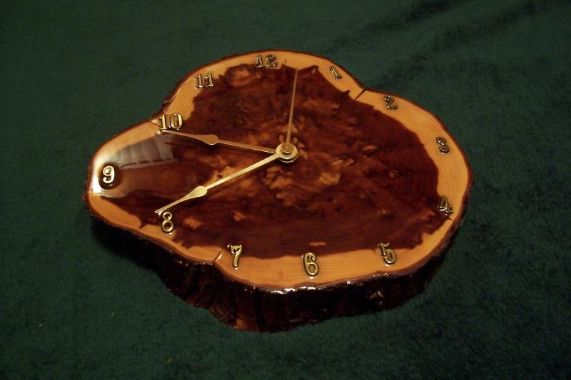

I've used this:
I picked it up at Lowes for about $20. It's a 2 part epoxy. Leaves a thick almost wet looking finish. Here's a clock I made out of a chunk of cedar.
That's the cured finish.
Yeah, I've used it many times before, is also know as "liquid gloss" or liquid glass"...!
Not easy to work with, unless is a totally flat surface but like anything in life, you can learn how to use it in curved surfaces like pen blanks...!:wink:
Cheers
George
