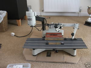

Hello.
I have two engraving machines of Gravograf, a little like the picture and a larger one. It is the picture I bought second hand for approx. 1,500 Swedish kronor. Works really well even though it is old.
Urban
