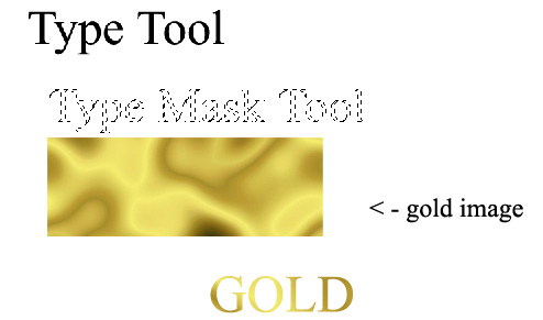

Alpha -- I was thinking of doing just that. I only have gimpshop and paint.net. I may have to reach out to my geeky friends to see if they can get it to work out right. I tried it with another Jr. Gent that I have laying around and can't seem to make it look 'natural', make sense? It looks like I typed it on a picture..which I did. ha!
I haven't touched Gimp in many years (several versions ago) but it should
do what you want.
The Text function should allow you to choose a Type Mask, rather than
the text itself. (does that make sense?) When you type a word, you won't
see the black text (or whatever color) but you will see the 'marching ants'
in the shape of letters you just typed. You can fill that with color, or you
can fill it with a pattern .. or you could even take a photo and "Paste Into"
that area. Basically, it is a Selection, but it is in the shape of your text.
(In your toolbar, it might show as Text Outline or something similar)
So . .if you look online for some images or color swatches .. for instance
if you're going to fill the text in gold, search for a gold image online. Copy
that image and use the Paste Into function to put it in your text. The
nice thing is that even after you Paste Into, you can still use the Move
tool to move the image around .. still within the text.
Edit
I just did a "Quick and Dirty" version so you can see what it looks like
