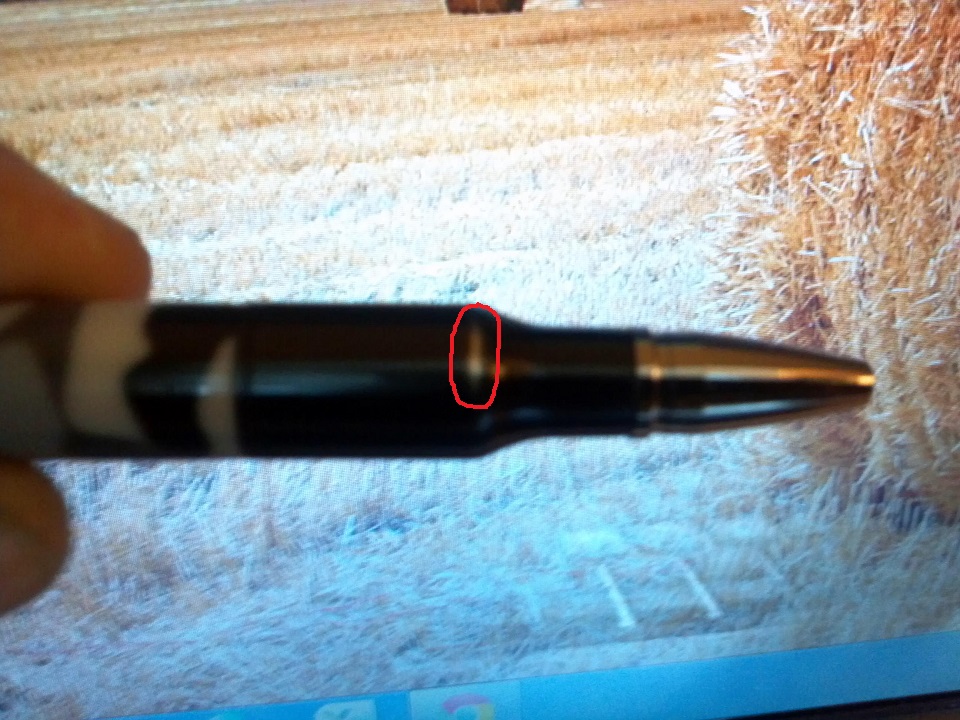

I had a customer ask if i could repair his black enamel bolt-action's lever that became loose after it was dropped. I'm assuming all it needs is to realign the lever and tighten the screw. As I was looking at the pen, I noticed and was surprised to see the enamel, immediately above the crease where the pen would normally be held to write with, worn down to the metal. The rest of the enamel is fine. He didn't complain about it, only after I made the comment that it doesn't look like it's holding up too well, said " I use it every day". He's only had this pen for about 2.5 months, so I gave him a new pen.
Is there a enamel durability issue with these pens from normal everyday use?
This is the area of the pen I was trying to describe...

The enamel that they use is enamel paint (similar to the car industry). Any ridge that is painted will be thinner than the flat areas (bodyshops never sand a ridge, they will sand up to the ridge, but never on it. You will sand through the paint in no time).
This is why that spot is worn faster than the rest. BUT, The enamel will wear away eventually regardless. I have a friend with a Irish Bog Oak Cigar that I made about 5 years ago. The Bog Oak looks great (friction polish finish), The hardware...... The Platinum plating has held up well, and the parts that were Enamel are now a lovely brass finish. He's happy so that's all that matters.

Maybe the man has dry/rough skin on his fingers?
I realized when I purchased these kits that the enamel paint would wear off eventually from use, but didn't think it would happen this fast.

Black Enamel has a wear factor similar to 24K gold. It will wear about as fast as any plating.
I'm still fairly new at working with pen kits, so I'm not sure how they rank as far as platting or paint durability. I would hope there's a significant difference between a kit plated with 24K gold and one with titanium or rhodium.
As far as this black enamel bolt-action's paint goes or any kit really, 2-2.5 months of use resulting with the paint worn down to the metal is totally unacceptable to me if this is normal or the average.
I wouldn't give a pen like this as a gift to someone let alone sell them one.

Was the rub mark aligned with the clip (or 180°) from it, if so that would indicate to me that its from pocket wear.
Looking at the clip head-on, it's 270° in a clockwise direction. It is located where I would normally have my thumb. I wish it wasn't there, because I really love this design.
