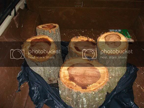

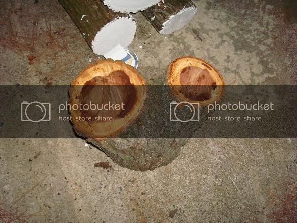

Here's a few pics of the loot. I'm hoping to get some blanks that show both the heartwood and sapwood on the same blank:
I have never seen pecan in log form before, but those look a whole lot like all the sugar maples that I have seen.
I don't think I would debark. I think the bark holds in moisture and would help it to dry slower.
Naw, that's hickory (pecan) alright. Very pretty pecan at that.

Trees like that I go for the 2" to 3" branches with forks. Much eaiser to deal with and the forks is the best looking wood in the tree. Years ago I did the same thing, draging home big pieces of wood I never used. I had a dump truck load of wood I cleaned out of my shop last year. Try smaller branches, most times you can make a two toned pens. Heartwood, sapwood together.
While I agree that smaller limbs are easier to handle...the wood is not the same (even from the same tree). I believe, that the older the wood, the better it gets (just like wine). Thus, the nearer the wood from the base of the tree, the better it usually is. Of course you also have to factor other features such as curls, burl, crotch, etc.
Personally, I normally won't touch wood that are less than 8" in diameter from these bigger trees with exceptions on really slow growing plants (bush/tree).

Ryan, if I could I would. I'm totally sawless so I've got to wait to hand them off. I painted them, stuck them in the shed and so far not a single crack (that I can see through the paint anyhow). Used latex Killz.
Cindy, I had thought about that pruning stuff. Nobody suggested it so I nabbed the paint. Seems to be working well. If that pruning spray ever gives you trouble, you may want to try the paint.
