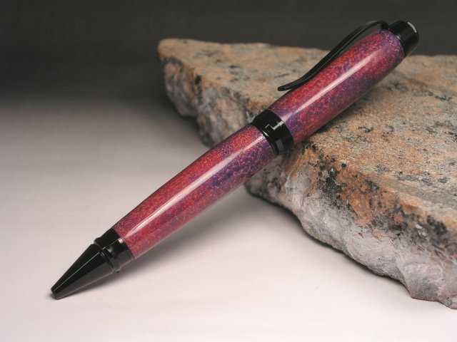

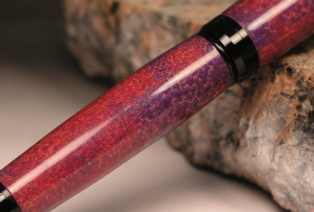

Jeff,
I have made a few pens with the embossing powders. I used a spray adhesive to bond the powder to the wooden blank and then flamed it with a propane torch. I creates an interesting effect. I then applied a CA finish over the top and made it really thick to smooth it out. Casting of the finished pen would have been nice too. The powder could be used as a gap filler too as it is fairly fine.
Cheers,
Fangar
