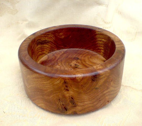

Hi All,

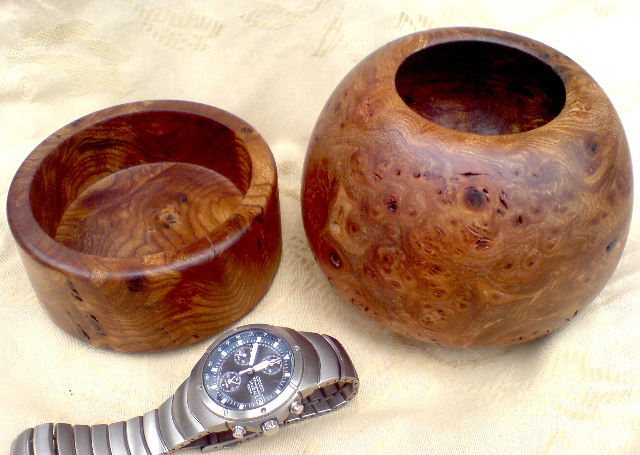

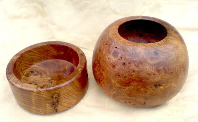

A couple of my latest bowls turned from Elm Burr.
They are not that big, but I tried a different finish on each.
Modern bowl was given sanding sealer, then BLO and beeswax finish. Round bowl was given two coats of sanding sealer, a light coat of BLO and buffed with a crystalline wax polish.

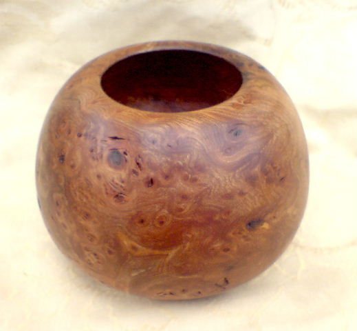

Hey, y'all, uh, I don't want to be the wet blanket, but, uh, they're both round...
And both really nice.
I like the spherical one. Did you use some specific kind of tool for the inside of the hollow form?
Julia
Hi Julia,
Thanks for the comments.
I used a bowl gouge to make the initial cuts into the bowl and then finished the sides using a round nosed scraper.
I dont have any specific tools for making a hollow form which is why I stay within certain boundries, and dont make anything with too narrow an opening, or too severe angles inside.
But I need to invest in some good hollowing tools.[}:)][:p] (More Money)
