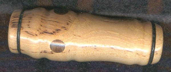

The suggestions for ultra fine sanding mediums, including steel wool, gave me an idea. Why not wool? As in: real wool. So, I dug into a box of historical reenactment garments and came up with a scrap of wool blanket material. Following Tom and Lou's and others suggestion to fine sand with the grain between finish layers, I did just that with the wool. After sanding sealer, friction finish and melamine, I rubbed the shown duck call with the wood in an attempt to rid it of finish rings. The results are promising. A much small item, like a pen might react differently but I'll be using the wool for a while. Somewhere in the boxes of my reenactment 'stuff' is some sheeps wool. I'm going to dig that out and give a try later. Call barrel shown is spalted oak, usually not an easy wood to finish.

Frank just remember one thing.. raw sheeps wool contains a lot of lanolin.. that could cause a problem on any finish you put over it... you will need to get that off the wood before proceeding to another top finish... However, if you use it on the final top coat, it will probably give the pen a nice patina and smooth feel... don't know how long it would last though..

Originally posted by Old Griz
<br />Frank just remember one thing.. raw sheeps wool contains a lot of lanolin.. that could cause a problem on any finish you put over it... you will need to get that off the wood before proceeding to another top finish... However, if you use it on the final top coat, it will probably give the pen a nice patina and smooth feel... don't know how long it would last though..
I found my wool. These are processed skins, the lanolin is gone. A follow-up test was non-productive. The blanket was more successful.
