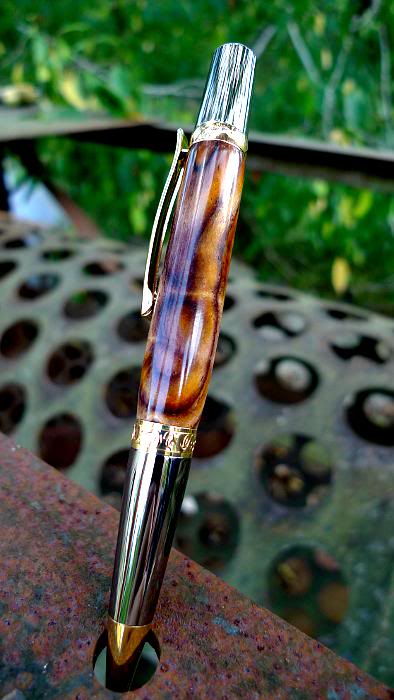

Just started turning a few weeks ago, I've sold around 16 or 17 pens so far. This is the latest one I made, my favorite so far.
Nice piece of wood, but it might have looked a bit better with a slight bulge contour, not enough to make it look preggers, but just enough to add some shape, rather than straight bushing to bushing, the Finish looks pretty good, what did you use?? If you're doing work like this after three weeks, I think you'll do quite well at this insanity.

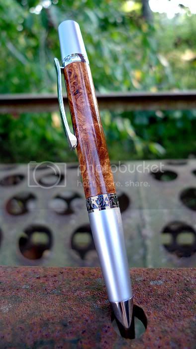

Thanks everyone. Finish is CA. I had another similar kit so I tried a bulge like you suggested. I'll let you judge.

If you don't mine me critiquing your "bulge" ... when I turn a Sierra it looks basically like this one at the top but at the nib end I taper it down to the bushings with no bulge. I suppose the best way to describe it is to combine your original posted pen and this second pen.

I prefer the second pen to the first one, but that is just personal preference I suppose. When writing with it, I prefer the feel of the pen with a slight bulge in the body. Nicely Done.
