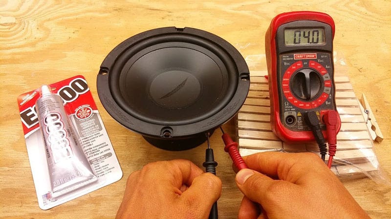

First thing I would do is check for electrical continuity on the speaker sound coil . . . if you can find a way to get at it.
You will need an ohmmeter . . . The resistance of the coil will be something under 10 ohms . . . BUT NOT ZERO.
Infinite resistance means, of course, that the coil is "kaput".

The cone seems fine - no tears or the like. I smelled some sort of electronics smell just as it went, so I assumed a capacitor leaked...btu I can't find one that looks bad. It makes no sound at all. There's power to the tweeters (or whatever the little speakers are called), but nothing at all to the sub. The sub shows 3.8ohm resistance, and it's stamped at 4ohms. I'll dig into the links - thanks!
If the coil of your sub measures 3.8 ohms ( with nominal specification noted as 4 ohms ) it would seem there's nothing electrically wrong with the sub speaker coil itself. . . . Thanks for getting back to us on this, Andrew.
