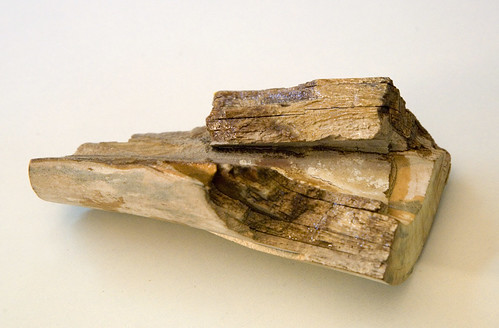

Up in Alaska last summer, I bought this piece of fossilized mamouth ivory. (The shiny areas are thin CA, poured into the cracks.)

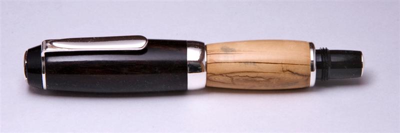

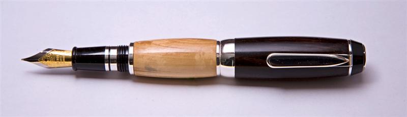

It's about 4" long -- the pen that follows was made from the piece on the upper right. I chose the El Toro in sterling silver from Lee Valley Tools because it requires quite a small piece for the grip.
The dark wood is African Blackwood.
It's interesting that the ivory looks like wood. The stains and blotches are natural -- they became visible during the final turning and sanding. The wood grain appearance is from the layers of ivory. I guess as the animal grew, the tusts expanded in layers, much like a tree trunk. The long cracks were there and filled with CA before turning. The ivory was easier to turn than antler, but was slow; it would have been expensive to have it fly apart. Drilling it was the scariest part -- it took a couple of evenings, moving up in size with several bits, and filling cracks with CA as I went.
I gave this one to my wife, and she seems to like it. While it's a bit of an oddball looking fountain pen kit, it's comfortable to write with when the cap is screwed onto the pen body.

David -- yes, I must admit that I was disappointed with the appearance of the ivory in the final prep before finishing. If this was wood, it would have been rejected. But I hope the fact that it is 8,000 to 40,000 year old prehistoric mammoth ivory will give it some different appeal.
Marla -- This piece of ivory cost approx $50.00 and with a bit of luck will make five pens. I do intend to sell the remaining four -- this one has been a learning experience. I have no idea what to charge. I guess it will depend on the finished pen's overall appearance. Hopefully the next won't have that mottled appearance as this one does...

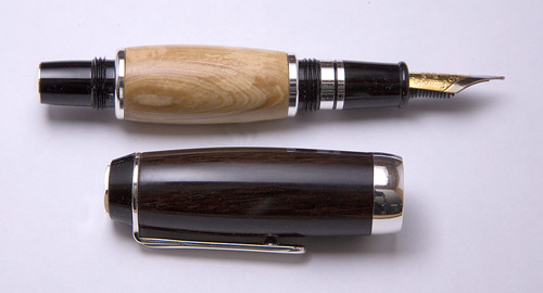

Great work1 is the pen really as sort and squat looking as it is in the picture?Had to jump on Lee Valley's site to check one out.. looks a bit similar to a Woodcraft El Grande.
Stand corrected the body is considerably shorter....
Steve, Any chance you could tell me the tube lengths?
Hello Wayne, I can't measure these tubes to a great deal of precision without disassembling, but I put the calipers on the assembled sections best I can. Looks like the grip is approximately 1.40" and the cap is 1.85". This is, say, +/- 0.02".
