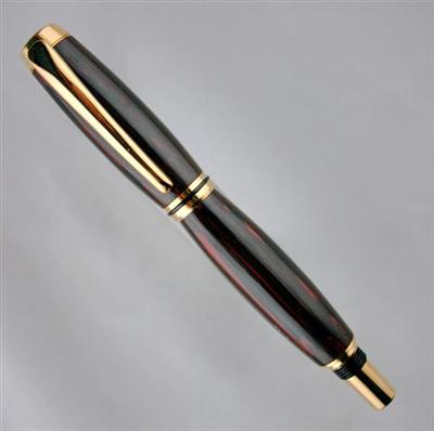

I am working on a Patriot that I turned using ebonite. I can't get the ebonite to come out to a consistant finish; no matter what I do it turns out splotchy.
I searched the forums and tried both a natural finish (polished to 12000 MM) and CA (again polished to 12000 MM); both come out splotchy. It looks like it might be the ebonite itself. With both attempts I started out with 400 grit and worked my way up to the 12000 from there.
Any suggestions/tips on how to get it to a consistant finish i.e. either all glossy or all matte? Given my preference, I would like to go glossy.
Thanks.
Generally I do not put a finish on ebonite. It should sand & buff out very nice.
After your MM, I buff with tripole and then the white diamond and that's it.
I have put enduro over black ebonite, as it will keep the black from oxidizing.
