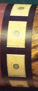

Buy some Brass, Copper, Silver or Aluminum tubes from your supplier.
Fill the tubes with colored epoxy using a syringe.
When the epoxy cures you can use those tubes to make inlays in your blanks.
Drill a hole that the tube will fit snugly into.
place a drop of CA in the hole.
insert the tube and let the CA set.
Cut the tube flush with the blank and go to the next hole.
The holes can be straight in or at an angle.
When you turn the blank you will have nice little inlays in your pen.
