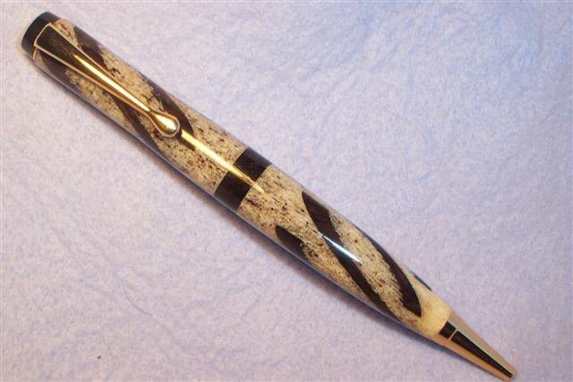

For all of you who thought that Eagle had just dissapeared , here's a picture of one of his latest pens that he e-mailed to me
It's made from Mule Deer Antler (about 95% pith) and African Blackwood . It's made from a slimline kit with extra parts .
HOLY COW!!! (or, more correctly, deer) That looks amazing! Thank you and Eagle for sharing.
Any idea where he got the finial and clip?
Unmistakably Eagle's mark. Super job on the inlay & design. Touche [;)]
Jim, that clip looks like one that came out of a plastic bag..[:D]
That guy keeps getting better and better.
Great work Eagle. I wish that I had your talent.
I'm also envious of that finish.
After Eagle read all of the responses to the posting , he sent me this e-mail to answer some questions about the construction of the pen .
After reading the replies I thought you might want to edit your post to answer any questions.
Most importantly the fact that the inlay was not my idea.
I have been intrigued with spirals and glue ups since I first started turning pens so I thought this would be a good chance to give a try at both.
I figured if you had any questions you would e-mail me direct.
Recently there were two posts that got me to thinking,(dangerous situation)
One was about turning antler with a large core(porous pith).
I sometimes run across that in antler and just "wing it as I am finishing it.
I received a large trunk of mule deer from one of the guys at the hardware store and
most of it was too big for turning pens,In this case I was able to get a 1"square piece to start with.
Ca is the answer but I don't make too much attempt to fill with dust depending on what I "think" it will look like.
On this particular pen I used thin ,medium and thick CA.(I have a tube of gel but couldn't find it.
The other post was inlaying the spirals.
RPM made the initial post
http://www.penturners.org/forum/topic.asp?TOPIC_ID=5395
and Knotty harry did a follow up
http://www.penturners.org/forum/topic.asp?TOPIC_ID=5497
I played with it this weekend and discovered"less is better"
In one instance I had as many as 12 pieces of inlay in a 2" blank,of course there are
2 blanks to a pen.
When I turned it the result was much too busy.
This is a slim line,I had a stud from some custom finial stuff I bought,
The clip is from an American Classic from Woodcraft.
I might turn an antler finial might not.
