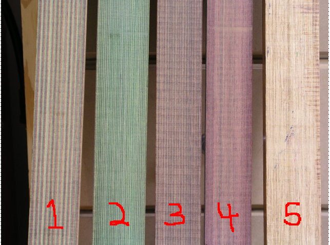

I don't know about the finishing of it yet, but I have dymond wood falling out of my underpants... Ok not really, but I have a huge pile of it. Not sure what to do with it yet...
Each piece is approx 3" wide by 5 feet long.

LOL... haven't really thought about it. Still trying to figure how to cut it up. I might do some sort of angle cuts, to make them looks a little different when done. The boards are not quite 3/4", but I think they are close.
Fangar
