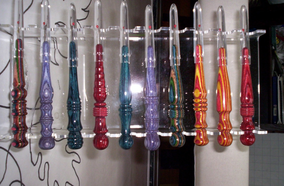

It's funny - I was just trying to decide whether to give away some is the cheap ones I bought to make inserts. The plastic colors seem cheesy to me.
It seems that you have found a nice way to really class them up.
Any chance you would consider sharing any tips on making these?
Looks like you are removing the blade from the little plastic handle that it comes in. Any tips on getting it out?
Do you drill a hole for the blade to go in or something different?
Just test the cover to fit as you're turning it down? Do the covers stay on okay?

Butane lighter or mini torch and needle nose pliars gets them out every time.
Turn to fit the cap.

I used to make mine this way. Then they started coming back to me because either
A. someone broke the tip off trying to pry something with it, or
B. it got dull.
Now I make the handle, drill it with a 7mm bit just deep enough to holster the ripper in, and put the ripper, in it's little plastic handle into the turned handle one way for use and pull it out and reverse it, to act as a "holster" for the ripper to protect the tips. If it breaks, or gets dull, they can replace it with a new ripper from any fabric store.
I used to make mine this way. Then they started coming back to me because either A. someone broke the tip off trying to pry something with it, or B. it got dull. Now I make the handle, drill it with a 7mm bit just deep enough to holster the ripper in, and put the ripper, in it's little plastic handle into the turned handle one way for use and pull it out and reverse it, to act as a "holster" for the ripper to protect the tips. If it breaks, or gets dull, they can replace it with a new ripper from any fabric store.

Chase1957, I don't use a kit. I purchased the Dymond Wood 5/8" dowels from Rutland plywood. Rutland is now out of business, the factory burned to the ground last August. My wife runs a long-arm quilting business out of the house and buys the rippers in bulk from one of her distributors. I caps are now made from 6' lengths of tubing I purchase from U.S. Plastics.
I don't have to many returns on the seam rippers. I also make stilettos, hand presses, needle cases, and lace bobbins from the dymond wood. I usually make about 2,000 sewing tools a year.
I keep watching for info on Rutland to see if they are going to rise from the ashes, or sell their process. Their range of colors was fantastic. It didn't need any finish, just buffing and polishing. The resin impregnation made the difference in my opinion. Much better than Spectraply, which is about the only game in town now.
I made a couple of knitting needles that they love the feel of especially, in addition to looking great.
Wanted to make some crochet hooks, should have stocked up on it.
Great looking seam rippers. I have a hard time sanding the groves when putting small beads on my work. Just curious on how you sand them?
Seven
No, I touch up the beads with sandpaper. I start with 400 grit and work my way up to 1200. It only takes a short time with each grit, the Dymond Wood sands easily.
