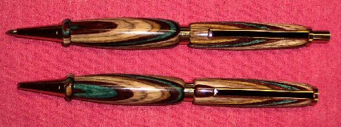

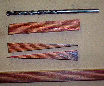

I don't know how I missed this thread before , but I've done about 100 pens with dymondwood and never experienced these problems . As you can see from the attached picture , I buy all my dymondwood as straight grain wood and then cut and glue them up for a diagonal pattern and I've never blown one out or gone off center by any more than , maybe 1/16" , I do use a V-block to hold the material while drilling and I use a speed of 1100 rpm , treating it the same as steel with plenty of backouts to remove the accumulated dust . The bit is a HSS bit . I always start the bit by using a 1/8" brad point bit , in a hand held drill , drilled to a depth of about 1/16" for a lead , to stop the bit from wandering at the start . I do use a barrel trimer in a hand held drill to square up the ends but it MUST be sharp . I always have to watch myself in using it right after sharpening because it cuts like crazy .
<br />
<br />I don't use water or any kind of coolant to cool the bit nor do I wet sand , although I do use wet-dry paper ,and my results have been great as you can see from the pic of the pen & pencil set .
I hope that this is of some help to those who are experiencing any problem with Dymondwood .
