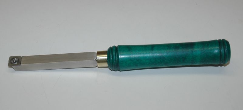

I used ink to dye a maple blank deep green. I bought a Woodchuck Pen Pro without a handle, and decided to turn my own. I wanted it to stand out from my other lathe tools. It does. :smile:
I turned the handle to shape, and then applied the ink with a small rag. I used a wipe-on poly finish to seal the blank from possible bleeding during use. Note that this is a utilitarian finish, I did not spend a lot of time to make it smooth and glossy, like I would for a pen or other lathe project suitable for sale. It was just an experiment.
The ink came from Hobby Lobby. They had quite a few really intense colors.
