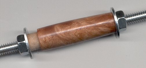

Funny you should ask
<br />
This is a Maple Burl that I just finished dying brown. After turning I sanded with 400 dyed, let it dry. Micromeshed through all grits and dyed again. It looks good to me, but not enough info yet to be sure.

what method of dying did you use?
Sorry I guess I forgot the most infortant part [:I]. I applied a moderate amount of dye on a folded up paper towel and applied it with the lathe spinning at slow speed. I really do not think it matters if the lathe is spinning or not.
As a note I have a feeling that you would get better penetration in the blank if you did not sand as much as I did, which is why I aplied prior to the Micro Mesh as well. But like I said still have to play around.

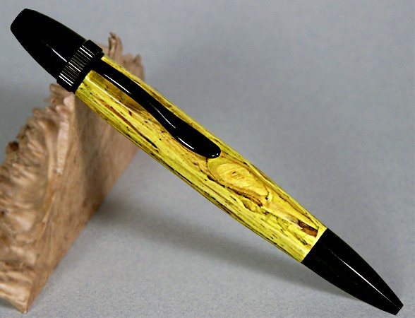

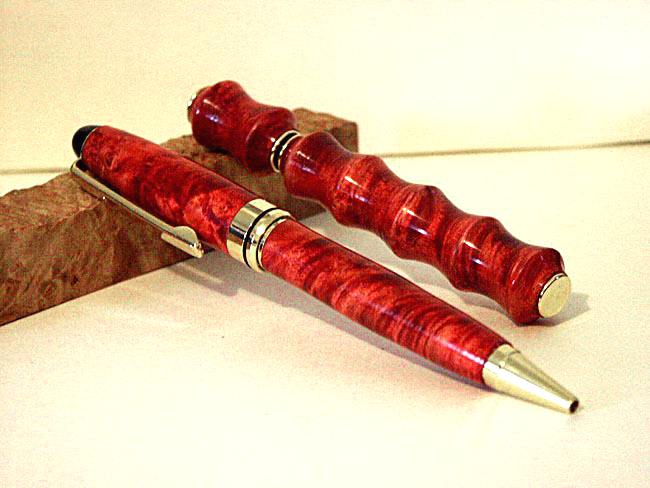

I have tried two different dying processes for pen blanks and both have worked...
One is Chestnut Spirit Dye.. basically any NGR Alcohol based dye is the same... and the other was a bottle of acrylic artist ink that I got at the local craft shop... it is water based and did raise the grain a bit, but not so bad that a little 0000 steel wool could not take care of it without removing the color... both dyes can be steel wooled to reduce the color and give a more translucent effect which is what I think you would want to do with the big leaf maple...
I have seen Rit disolved in alcohol used on some scroll saw projects and it apparently works real nice.. have not tried it myself..
As for lightfast, the red set was made a year ago and it is still red.. the yellow over 6 months ago and still yellow...
See the pics below... the red set is the Spirit dye the yellow is the artist ink... I would try the artist ink first as it is less expensive and should be available locally...
<b>Red Chestnut Spirit Dye:</b><br />

<b>Yellow Acrylic Artist Ink:</b><br />
<br />
