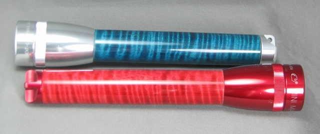

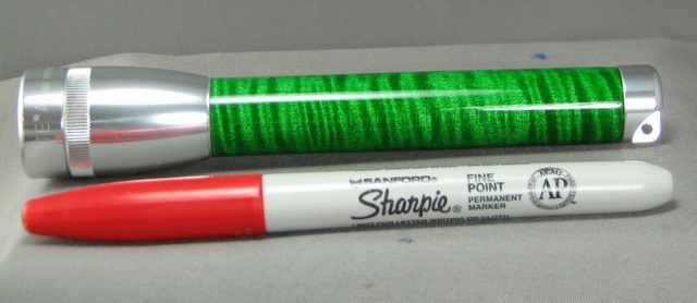

These are Curly Maple colored with McCormicks food coloring and finished with CA.
