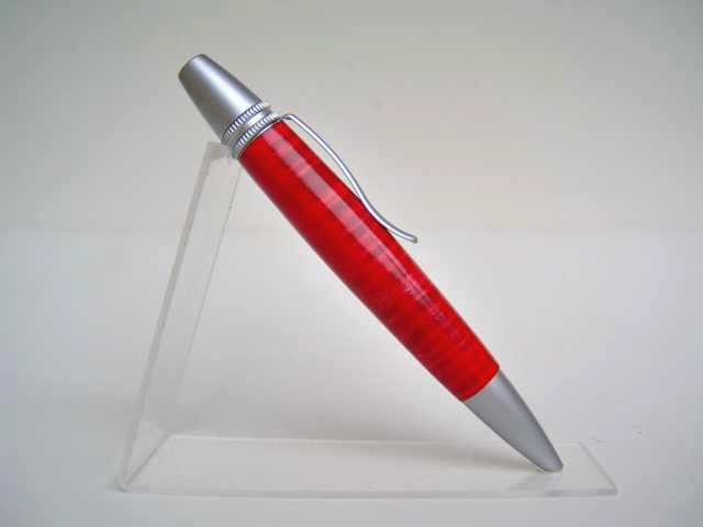

Just be careful to use food coloring without sugar (the gels with sugar don't penetrate and tend to glop up) I use McCormick Food coloring/Egg Dye and apply with a papertowl after I do the final sanding then finish with CA as normal

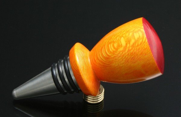

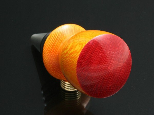

I have used it on Oak and it really accents the rays. Don't know about the Mahogany. I tend to rely on lighter colored woods that will take color really well. I have a Yellow and Red bottle stopper that turned out really cool and "shimmer" popped, although the picture doesn't really show it.

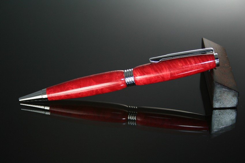

I recently purchased some Box Elder Burl blanks, and quickly realized they needed to stabilized. I had never don it before, but decided to give it a try. I put the wood in the bottom of a Tupperware container, added one bottle of MinWax Wood Hardner, and a good squeeze of blue TransTine I bought from Woodcraft. The nexty morning I went out to the garage to agitate the mixture, and the container was dry! The blanks soaked it all up, I took them out to dry, and they are tuirning nicely, and are gorgous.
