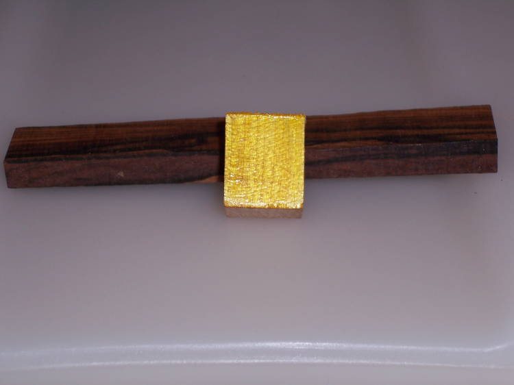

Quick question. I bought a canary yellow prismacolor marker the
other day. I have hardened the blanks with CA. Do you think when
I add the marker the blanks will turn red? I'd also like to finish
with several coats of CA.

I do know when you use a yellow Sharpie it does turn red. I have a red corn cob for sale because of that. Don't know about prisma color. Why don't you color on something and drop some CA on it and see what happens. Let us know what you find. I need to find a yellow that works also.

Was going to post a pic of the corn cob dyed with a canary
yellow prismacolor pen. Am having uploading problems tonight,
but I'll try again tomorrow. The marker worked really well.
I sanded, then applied the marker (went on really easily) and
then smoothed out with a little denatured alcohol on a paper towel.
Used CA as a final finish.[:D]

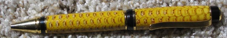

Here is a pic of two cobs. The top is natural and the bottom
is colored with a canary yellow prismacolor marker. I used a little
denatured alcohol on a paper towel to thin out the marker, it
was alot yellower.

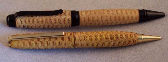

I used some Solar Lux stain from Woodcraft. Here's the pic;
http://www.penturners.org/forum/topic.asp?TOPIC_ID=4619&SearchTerms=corn,cob
