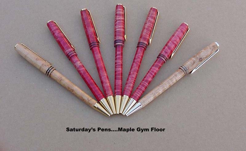

Curly and BE maple dye nicely. I dyed these pens with red aniline dye. I think figured lighter woods make a nicer dying medium than plain woods. I sanded, dyed, buffed dry and finished with CA. No sanding sealer.

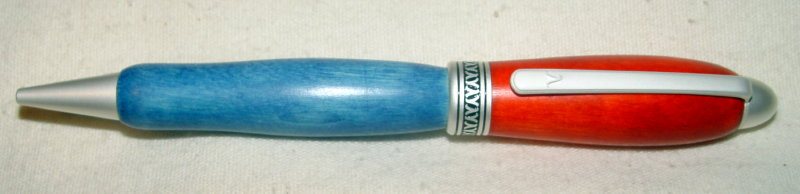

Thought you might like to see my attempt at dying pens. I call it a study in Red-White-Blue. The wood is curly maple. The dye is leather dye from a local shoe repair shop. My wife has it on hand of her craft stuff and I gave it a try. I am relative pleased with the outcome.

OK - at what point do you apply the dye during the pen making process? I've never dyed anything, but am thinking seriously, that it definately adds character to a pen.

Uhhhmmm, Yep. That is the one I want. Very intense. Is there a name on the package that I(we) can look up?
It looks like there was excellent penetration, not intended as a pun. Did you soak, vacuum, or just apply?????

Ken,

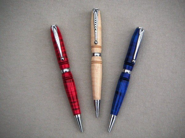

I've dyed lots of pens and curly maple is my favorite wood to dye. I turn and sand through 12000MM and apply the dye with lathe running at a slow speed...(so it doesn't sling the dye). I apply with the tip of a folded paper towel dipped into the dye. Let it dry and buff followed by usual finish, for me that is CA. I prefer to use aniline dye for wood. It is a powder mixed with water. Also, spirit dyes are used by some and sold by CSUSA as is the aniline dyes. Woodcraft carries anilien cyes and other woodworking supply stores should also. I have had no luck finding aniline dyes at local paint stores or home centers. Take a look here: http://www.woodturnerscatalog.com/catalog/finishing_supplies.html

This Dye comes in 4 fl oz bottles in a yellow box called Fiebing's Leather Dye. You can find it at most shoe repair shops. Some will have it in colors. I sand the wood through 400 or all the way to 12000 sometimes and apply dye with a paper towel and the lathe off. I turn the lathe by hand. I wipe excess off almost immediately. Turn the lathe on an continue to wipe the dye as it dries very fast. Once dry I apply EEE Ultra Shine and finish in my usual manner. If you want more information please let me know.

I can't give you an answer over a long period...but I can tell you that I have dyed pens that are six months old and they have no deteriation in color. That was with the leather dye that was used on those shown here. Red-White-Blue. I'm not concerned with long term exposure to UV. Think about your shoes. That is what this dye was made for.
