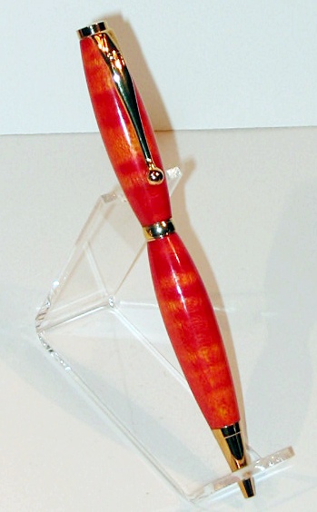

Food coloring works great to dye wood . Just turn your blank to size and finish sand then apply a few drops to the blank and rub into the surface until you get an even color then apply your finish . It doesn't penetrate very far into the wood so any sanding will take some off . It does give some very vivid colors .

Here's a double dyed maple using food coloring. I think it works great.
