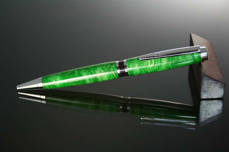

I have used Food Coloring to dye blanks after turning. Worked well. Fast. CA finished and pleased with the results.
That is one sharp looking pen, Dave! Given that you used food coloring to get that amazing result, are there any significant disadvantages to your process? Also,
  • What brand food coloring did you use?
  • How long did you soak your turned blanks?
  • How long did you let your blanks dry before finishing?
  • Did you sand after dying and, if so, what grit did you start with?
Thanks,
I have been toying around with writing up a PDF tutorial and maybe adding a video to my web site. It really is a simple and quick process that gets amazing results
1. I sometimes lose the tiny bottles on the lathe...
2. They can be hard to hold while dying...
3. And I have to share them with my wife... seriously!
Also,
    Safeway Private Label... nothing but the best!!
    I don't soak. I sand all the way to MM 12K, then apply the color right on the lathe. Whole process from initial sanding to final buffing takes about 10 minutes...
    About 30 seconds...
    Rarely, but if I do, I usually start with MM 3200 or higher
Source for food coloring http://www.sugarcraft.com/
Get the soft gel paste 3/4 oz squeeze bottle for 1.39 ea. to try it out. Turn the pen, sand and finish for your final coat, apply food coloring with a paper towel with the lathe on or off. You don't need much and let dry for a minute. It's ready for your top coating of CA. I used 4 coats of thin, sanded lightly with 400 grit to smooth it and finished with 3 each of med and thick. Micromesh and voila.
