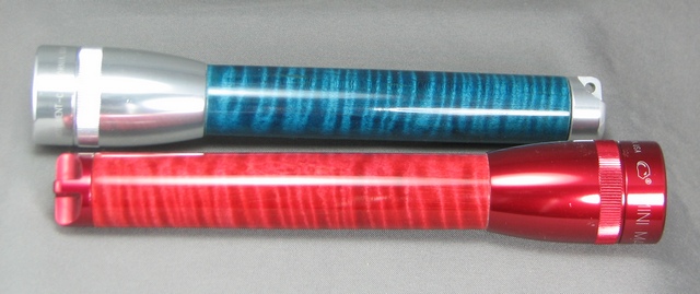

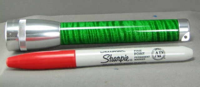

These are done with McCormicks food coloring from the grocery store. They'll last if you put a CA finish on like these.........
attachment.php
attachment.php

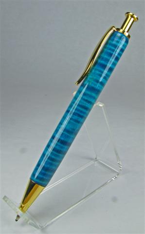

This pen won the Most Beautiful Pen contest in the 2010 Birthday Bash.
attachment.php
It's Curly Maple dyed with LV's Peacock Blue aniline dye, mixed with Isopropol Alcohol 99% pure. The pen was turned to size first and then dyed. Grain raising of the wood is abated when the dye is mixed with alcohol.
After the first coat was dry, I sanded it down slightly, then added another coat of dye.
thank you, i the slimline i just posted under (got money) was done with food coloring with 12 coats of thin CA i just wasn't sure how it would hold up.
