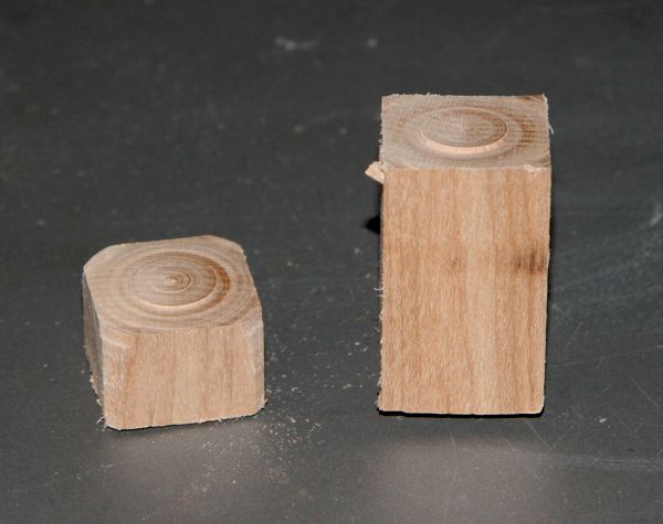

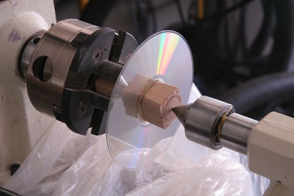

I turned a block in my chuck that had a tenon to fit the hole in the center of the CD but only 1/2 as thick as the CD. Then I turned a second one that would be pushed up against the CD with the tail stock. This tenon only 1/3 of the thickness of the CD so the tenons don't meet and the CD gets pinched tight.
attachment.php
attachment.php
Take your time, be thorough with each grit. And it will work out just fine.
