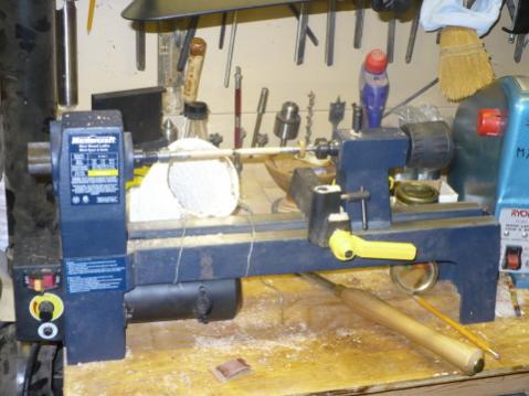

I just run my Rigid vacuum hose and have it spring clamped to the banjo on my lathe. I use that thingy you use to contain the hose when it is rolled up. I move the banjo and the hose moves with it.
I just took some 4" plastic clothes-dryer-vent-tube and hold it to the lathe bed/banjo with some wire-ties that come with those made-in-china toys. The wire ties are very heavy duty and hold the pipe at what ever angle you want. Cost: about $4.
