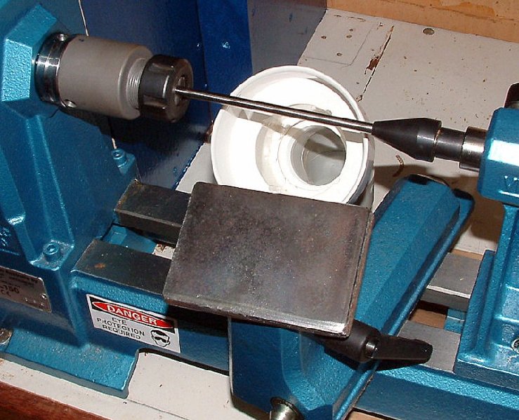

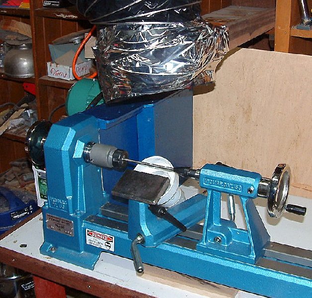

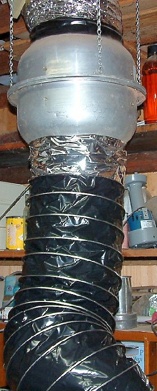

Tony, my recent take on my VL150 using a simple draught fan from the air conditioning industry above vented to atmosphere and where it belongs IMHO and below to a very strong dedicated vac with mid extraction.
Kind regards Peter.
