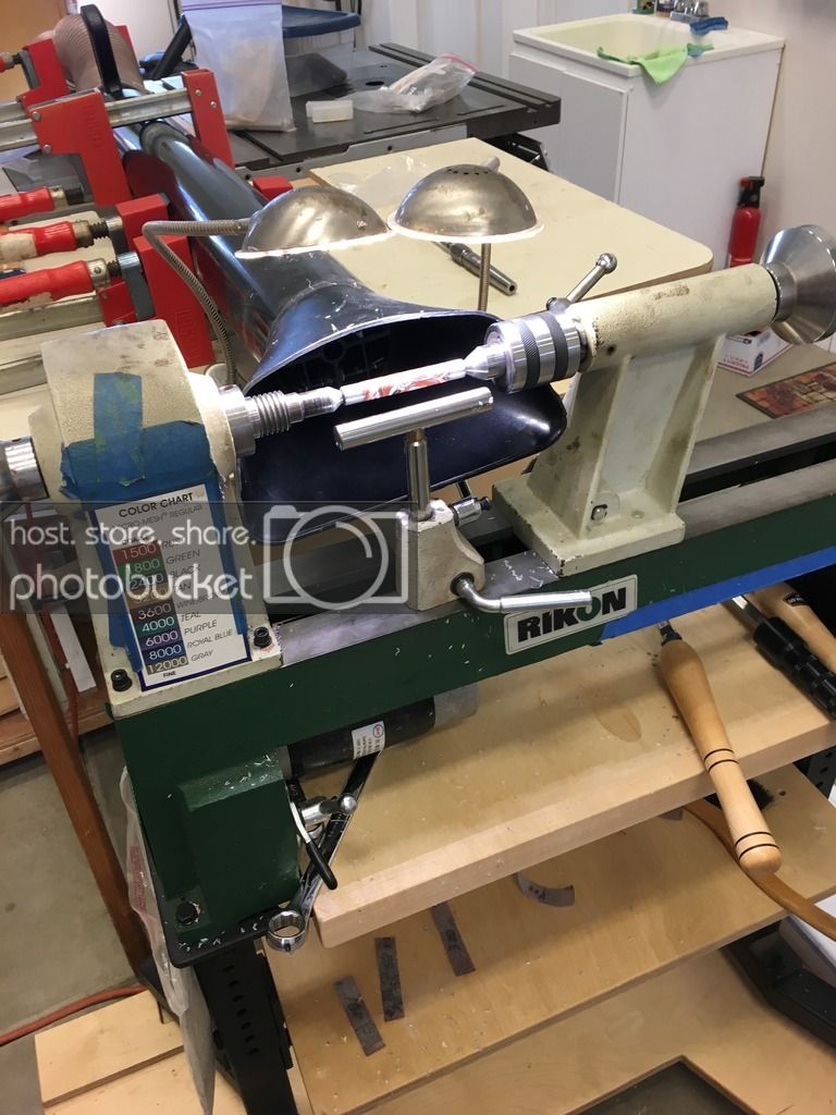

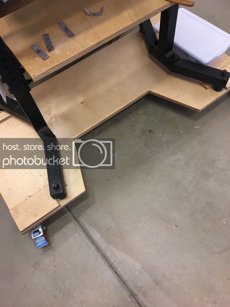

I am new to the joys of dust collection at the lathe and today was a good test. I need to amass more product before the holiday season so a load of sierras was on my workboard. I had a wide mouth Dust Right input just behind the pen body with Jet canister dust collector connected through a 4" hose. After turning 21 tubes here is the dust in the lathe and on the floor.
If the chips and dust are hard to see it is because there was very little not captured by the Jet. Strings of alumilite and acrylic acetate vanished into the wide mouth. Care was taken not to let the bushings, pen tube or Abranet sanding strips disappear into the vacuum. Cleanup with a shop vacuum took less that a minute. I have a couple of photos where the lathe, floor and I were covered in chips and strings without dust collection.

If that is all the dust that got away from the lathe........you are doing very well.

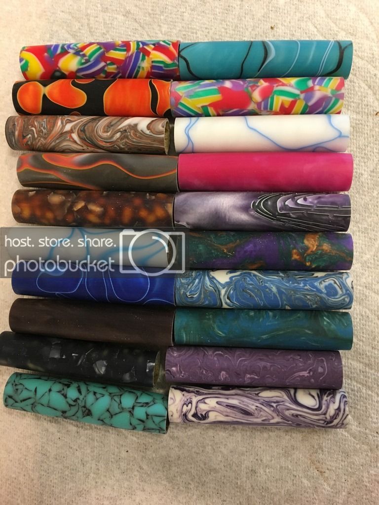

Would love to see the blanks when you are finished with the finish.
Great dust collection system !!!!!
And it's kinda nice to see those blanks ... some I recognize by name and have turned myself !!
You asked, you receive the photo

It is a busy time so iPad photo is all I can do. Here are the first ten.
Somehow trust me that they look far better in person, I might buy one...
It is a Dust Right shop floor attachment with about 4' of hard plastic 4" pipe. They are sold by Rockler. I bought the Jet canister dust collector and love it.
Thanks for that feedback Mmayo, I'm at the point where I need to step up my dust collection abilities. From your pic it seems you got it figured out--two thumbs up for you!!
