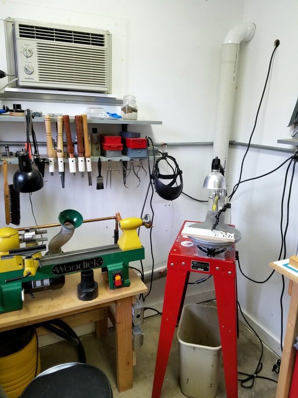

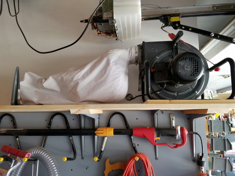

I hope this not considered cross posting because I posted something similar on Scrollsaw Village. However, I just finished reinstalling my HF DC today. Reinstalled because it was on the garage floor in the way of my wife's car. So it was moved above her car on a shelf. It is inexpensive using the little 13 gallon HF dust collector, 8'X4" PVC, a couple of elbows and a length of Dryer vent flexible tubing. Next thing to do is add a gate for my scroll saw. It really sucks!
