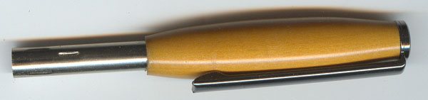

I know I'm goint to get zinged for telling this tale on myself. [:I] Maybe I should call this effort my Picasso. [:0] Look below and see if you can tell what is wrong with this picture. [:p] If I can rescue it, maybe I'll post a picture of the finished item later.
Well... you just gave me an idea .... clip on the nib end !!!
As far as rescueing it, put a 1/8" rod through the transmission, and push the cap off. Then use a 1/4" bolt to push the transmission out.
When I do this I hold the barrel in my hand, so I don't damage the barrel.
That's thinking outside the box. Just make it work and you'll get heaps of praise. You just need to say "Yeah, I meant to do that."

I was sure someone would zing 'conventional-ole-me' with a comment about outside the box or innovation. Don't mind. See results in another topic called 'two slimlines'.

I'm actually serious. It would make for a cool pen where the nib comes out a hole in the topside when it's twisted. It would throw people off guard. The shape looks like that could work.

Yeah should be no problem fixing that work of art. A small torch, 2 lb sledge hammer and an anvil.[:D][}:)]
for those of us that cant get the anvil, a slimline disassembly kit will work in a pinch. [:)]
I don't see where the problem is Frank. Just drill a 1/8 inch hole through the finial plug, and you have a nice pocket pen. [:)]
