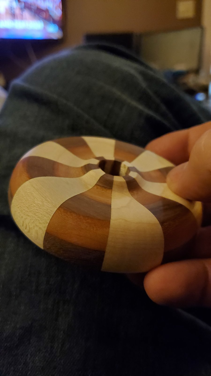

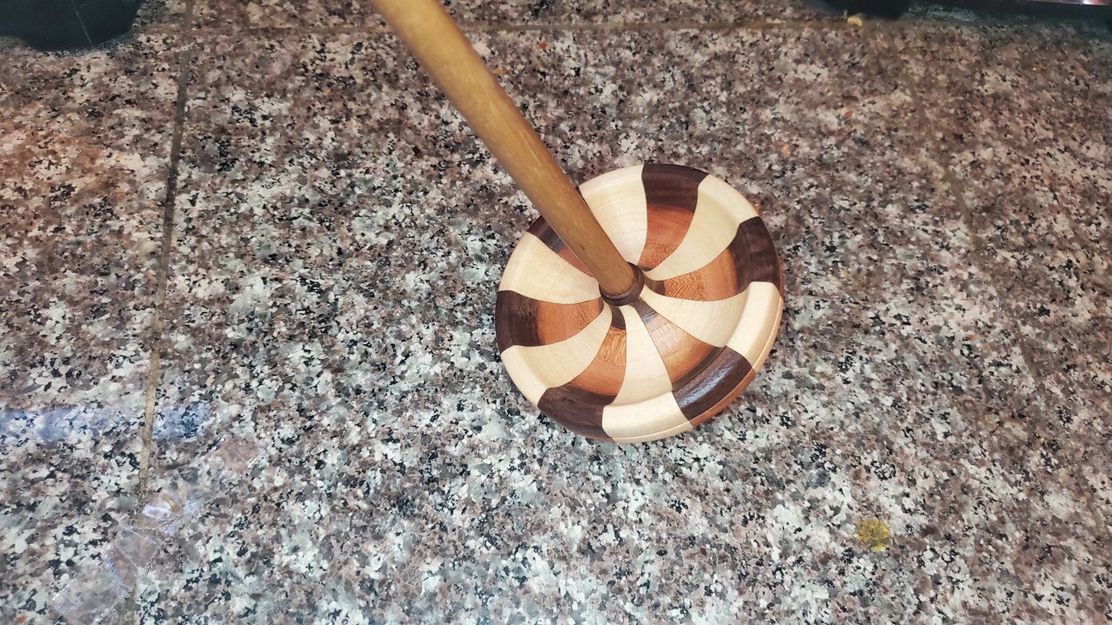

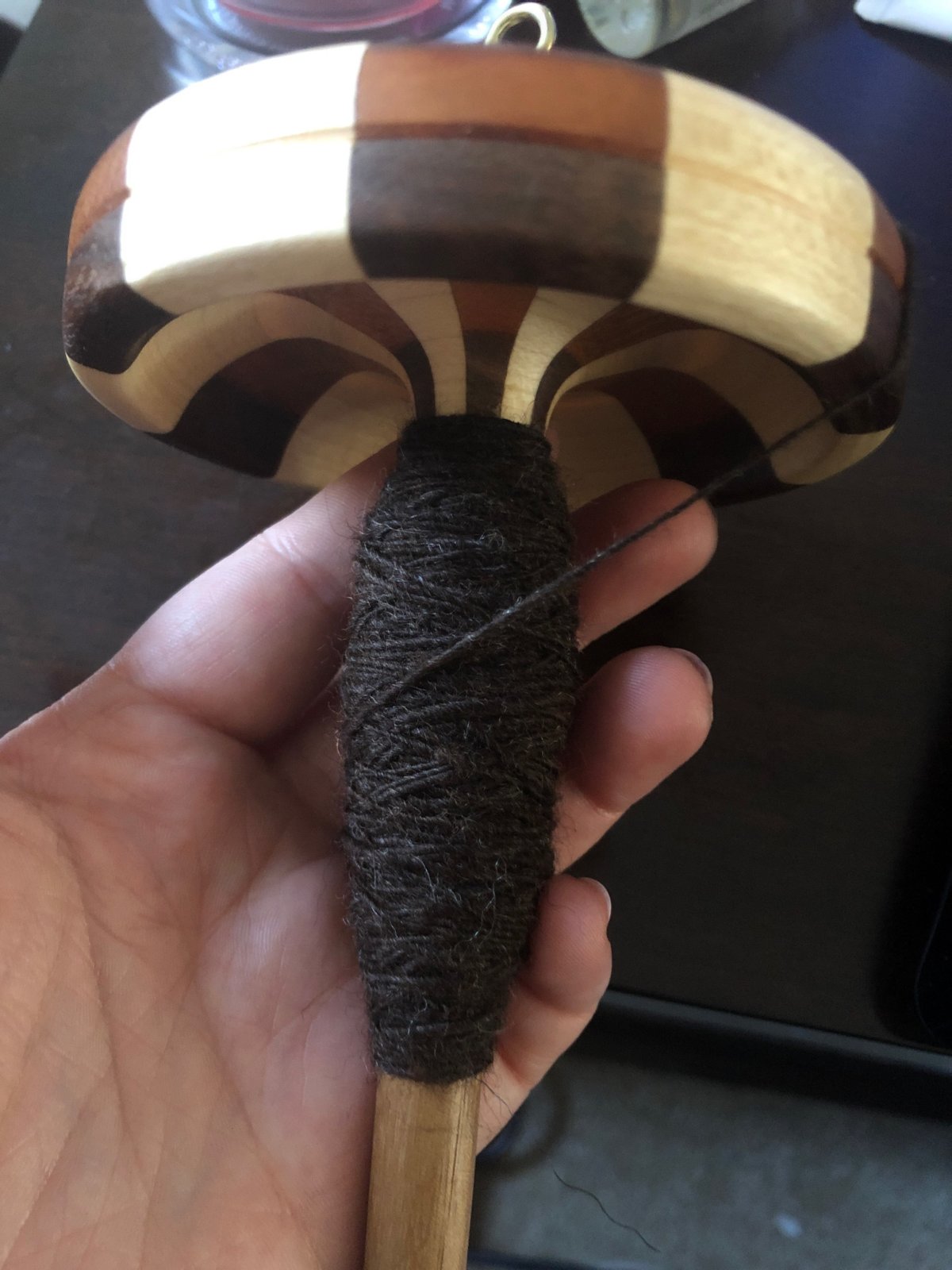

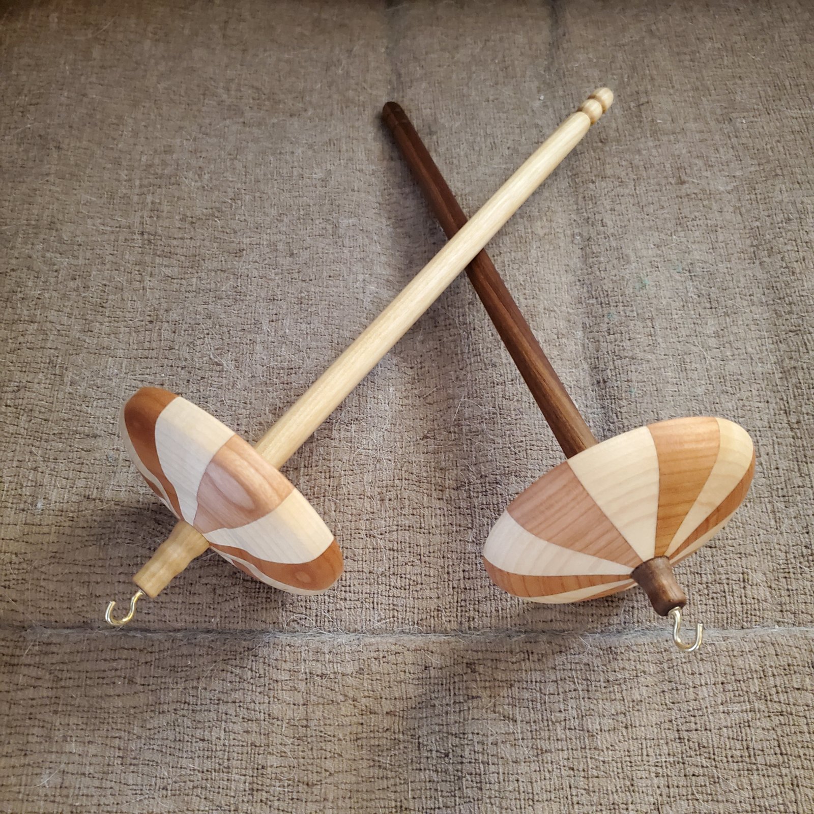

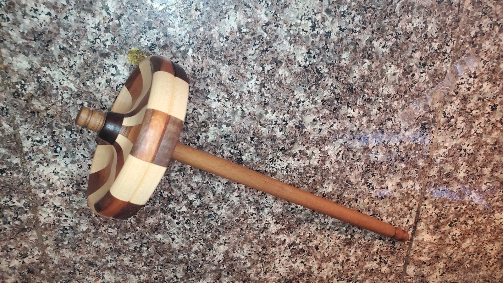

My DIL asked me to make some drop spindle yarn spinners for her.
She had very specific weight requirements the heavier the spindle the thicker the yarn.
Got some more usage out of my 12 sided segmented jig.
Why turn a simple spindle when you can turn a segmented spindle? ;) ;)
Wonderful work Cliff.
Thanks for sharing.

It's for spinning yard, used before spinning wheels. Here is a demo but this is a bottom whorl. I made top whorls.

Besides looking :cool: I think there is a little bit of engineerding* here.
By using segments the whorl is less likely to warp due to the grain not all running in the same direction, should make it less likely to split if dropped and balance is important so segmenting should also help.

Cliff, this is a way cool project. I love/admire the segmenting. Some day, I'll progress from 1/16" slices to 3/8"+ segments. Until then I can appreciate and admire.
Very nice

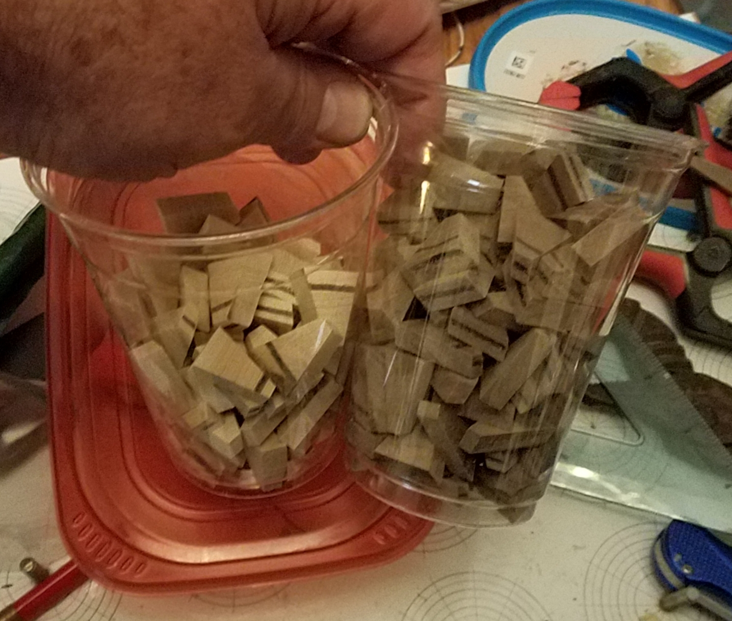

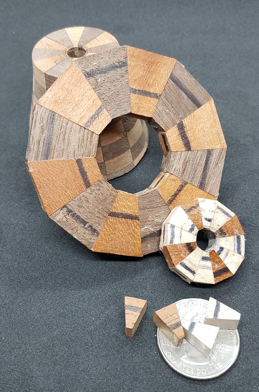

I'm giving my eyes a break and keeping stuff large scale for now.
To make the pen in my profile pic and few other projects like my segmented ornament took a few Solo cups of little pieces. :)
