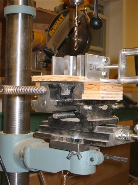

Here's the setup I use. I combine them
<br />
An adapter (from Grizzly) replaces the drill-press table. On it an x-y vise is mounted holding a self-centering vise. The self-centering vise allows me to quickly dril a bunch of 'regular' blanks, with very good repeatability. E.g. I can take .07" blanks and drill for a Gentleman's pen, and do a couple in a row, without futzing around too much. The x-y table allows me to drill antler blanks where the hole has to be positioned differently for each blank, very quickly. I use (vertical) jaw extensions on the vise to help align the antler curve. The whole affair can easily be lifted out and the table be put back in. May seem like overkill, it's something I've arrived at after a few iterations over many years and works very well for me.

Hey, Rich! I like! Where did you get the self-centering vise? Nice! That looks like a heavy duty quality piece of work. Can you easily replace that base piece of plywood under the center drill point? How long is the travel on your drill? Raising and lowering that whole assembly looks like it might be a bit of a bear!

My drill press has a rack and pinion to raise the table. So it's just cranking - not a problem. The vise is made by Paul Huffman (member here). I've used the PSI as well as the Woodcraft/CSU versions, plus various jigs I built - this one is the best. Mine is not exactly the standard one Paul builds now, but the variations are minor. I have room for exactly 1/2" softwood plywood under the jaws (whatever that thickness is exactly). I made up a stack of strips to fit the width and they last for years before i have to make more. The side loading is nice. Not pictured are top jaw extensions - I use these primarily for antler and take them off otherwise. The thick plywood block underneath is just to hold it in the x-y vise's jaws.
The drill press has a 5" (or thereabouts) stroke.
If I had to start over, I get a HF 12-speed drill-mill (42976) with built-in x/y table and much less quill play than this Delta I have. Of course mount a Huffman vise on it. The ultimate pen blank drilling machine! (I think ;-)
