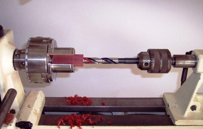

I have posted this a couple of times and will do so again per your request. I use a scroll chuck with pin jaws to hold the blank and a good drill chuck in the tail stock. Have never had a problem blowing out any blanks, wood or other. I drill about 98% this way and get very accurate holes. Hope this helps.
<b>Image Insert:</b><br />

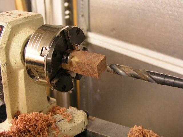

One thing to note is that when using a scroll chuck you want the corners of the blank to contact the rounder spots in the jaws. John's photos looks to be that way, but is not real visible from the angle.
Here is a photo showing that:

<br />One thing to note is that when using a scroll chuck you want the corners of the blank to contact the rounder spots in the jaws. John's photos looks to be that way, but is not real visible from the angle.

Well, I do not drill on the lathe, but my mind tells me that you would want the flats on the jaws. Less likely to spin should the drill grab. At least that is the way I drill any thing that is square in the metal world. Just my thoughts.
I'm with Paul. I always put the jaws on the flat sides of the blank. Seems like you could crush a corner and be holding the blank off center. Hmmm, I'll have to try it on the corners.
txbob &lt;--- still learnin' turnin'
Like the others, I use a 4 jaw scroll chuck when drilling on the lathe using the smallest jaws I have (pin or #1 should work). I've tried gripping the flats with the jaws, but unless the blank is dead square (and most really aren't), I've noticed a slight wobble that throws the hole off. As a result I grip them like James does (at the corners).
If I were to use my Beall Collet chuck, I would turn the blank round between centers first, then chuck it up with the collet that best fit the cylinder. And I may well do this for some of my locally harvested blanks so that I can get the desired grain pattern through the blank.[;)]
I see your thoughts Paul and others. However, Billy mentioned what usually causes the problem for us wood turners. The stock might not always be perfectly square. In this case the points into the cups tends to center the stock a bit better. I haven't had any problems with slippage though.
