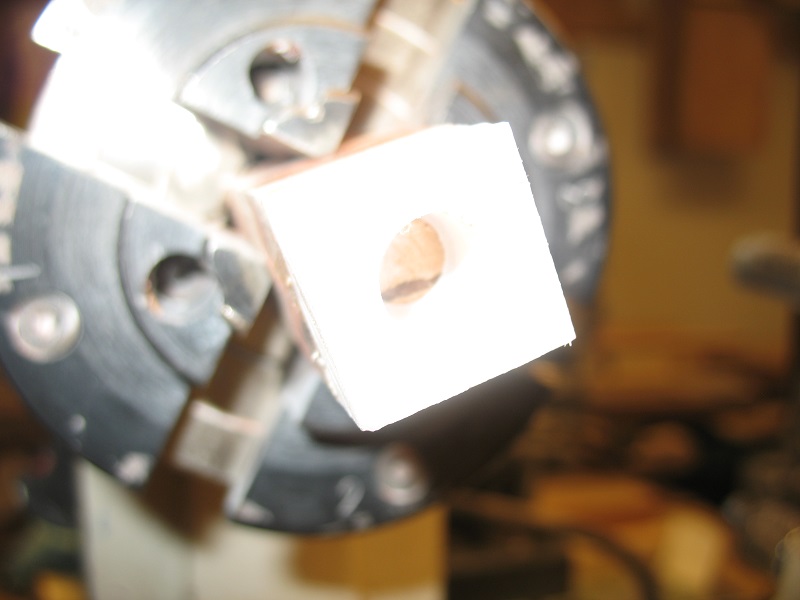

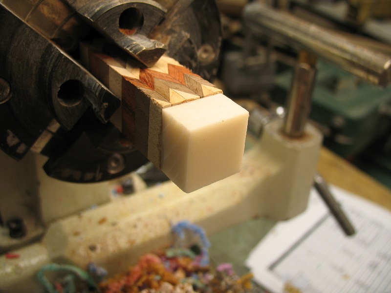

1 - Get a piece of that 1/2" thick Corian you will never use for a pen because the color is just yuck. Cut it into strips slightly narrower than your pen blank. Cut little squares from that. Use medium or thick CA to glue the little square of Corian to the end of your blank. Make sure the edge of the Corian square do not overlap the edge of the blank. Why...Later we will want to cut the Corian away, we'll want our blank to still sit flat for sawing. Here's what mine sample looked like:

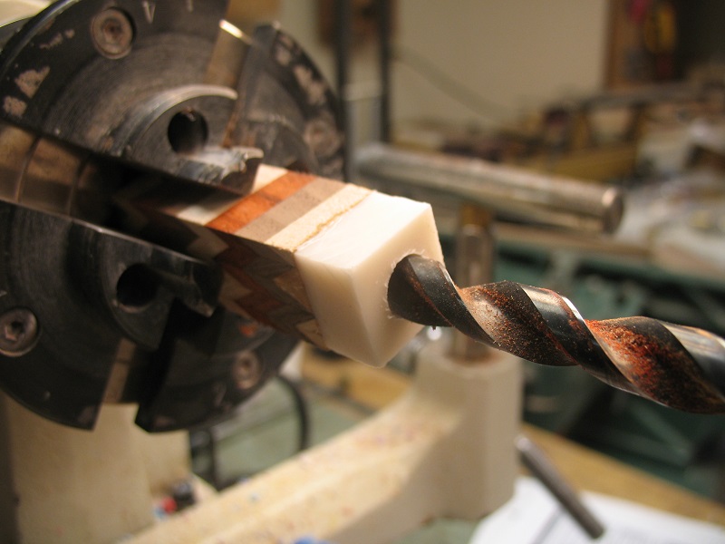

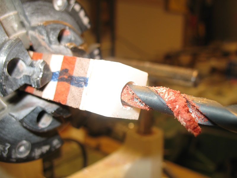

2 - This is a blank for a cigar pen which requires a 10mm bit. I use that bit to drill into the Corian a little more than 1/2", until I just start entering the wood. This is what it looks like (sorry about the over-exposure).

3 - Next I replace the 10mm bit with a smaller bit, then finish drilling through the blank. The smaller bit is only used to clear the way for the larger bit, reducing resistance, lessening tear out, lessening the chance of a blowout, and makes it easier for the Corian block to act as a guide for the bit shaft.

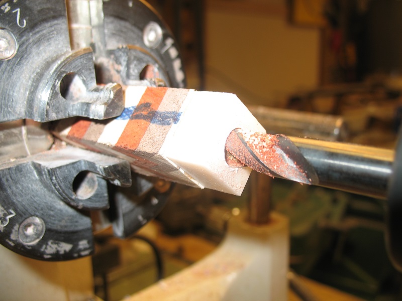

4 - I then replace the smaller bit with my 10mm bit and redrill the hole to the correct size.
