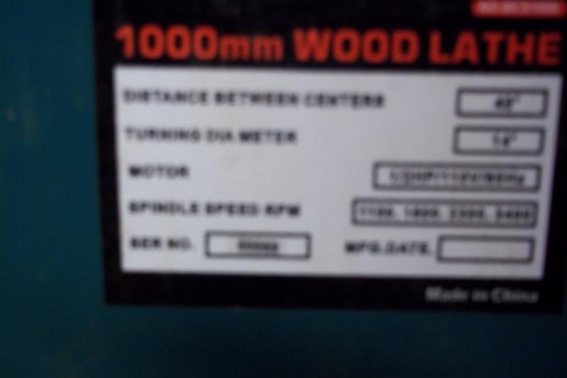

i agree, with yall about the drilling on the lathe, but i took parts to the woodcrafts store in chattanooga, but they didnt have any that fitted. cause my head stock measures 18 x 2.5 which i had the owner of woodenpost.com to make the part. tail stock is morse 1 taper, the lathe i have is according to the box it came in is a c.m.t 40 inch industrial wood lathe.. here is the description i got from the ebay listing where i bought it....
i bought a cheapo, now i wished i wouldve spent the $$$$ on a jet, or a better brand
.Construction - Headstock, tailstock, foot, tool rest base and tool rest of heavy cast iron. Bed is of heavy steel tubing.
Headstock . The outboard end of the drive spindle can also be used for large turning and is threaded 5/8" 16 left hand. The pulley system and motor are mounted to the headstock.
Tailstock - Slides along the full length of bed and clamps positively at any distance from drive spindle. The ram has a hand wheel advance of 2 3/8 inches with positive lock and is fitted with a No. 1 Morse taper
120 Volt
Frequency - 60 Hz
Maximum Length Of Cutting Feed - 40 inch (1000 mm)
Max. Diameter - 14-1/4" (365 mm)
Height Of Cutting Tool - 7" (178 mm)
Motor Power - Single Phase 350 Watts
Spindle speed - 4 speeds
Turning Capacity - 356mm (14 inches) max diameter over bed. 1000mm (40 inches) max between centers
Pulley system - 4 speed V belt
Spindle speeds - 1100, 1600, 2300, 3400 rpm
Motor - 350W, 1400 rpm, AC 110V, 50/60 Hz
pics... attached
