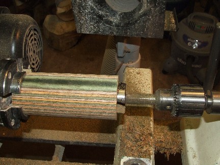

Same with me, except I mostly drill on my big lathe instead of the 1014... the biggest problem you will have on the little lathe is the tailstock quill only has about a 2 or 2 1/4 inch travel... you might need to back out of the blank, slide the tail stock forward to reset the drill and then turn the crank a little further until you complete the hole. I use my 1442 because my quill travel is about 4 inches and I can get all the way through most pen blanks in one set up.
Dave,
I forgot to include the pictures in my last post..

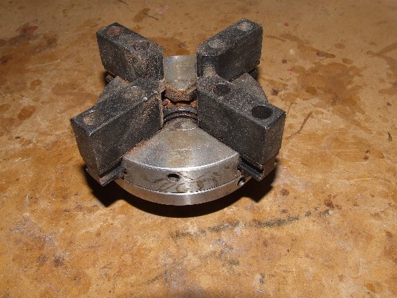

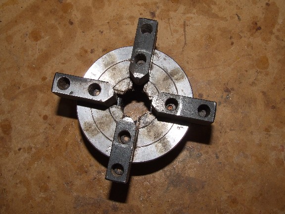

Here is a shot of the chuck I use to drill pen blanks... other styles are available and this just happens to be one I got a few years ago... also a picture of a pepper mill blank being drilled... I don't have a picture of a pen blank..
