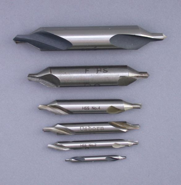

Bit wandering while drilling on a lathe is pretty common. Centering drills are made for just this problem and are readily available.
In addition to the centering bits, two other things that can help.
1. Dress the end of the spinning blank so it is flat or slightly concave before you use the centering bit.
2. Use SHARP! drill bits.
