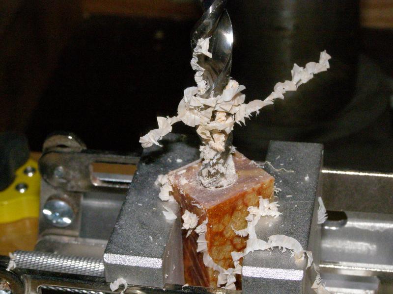

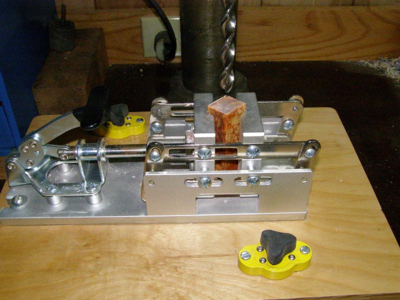

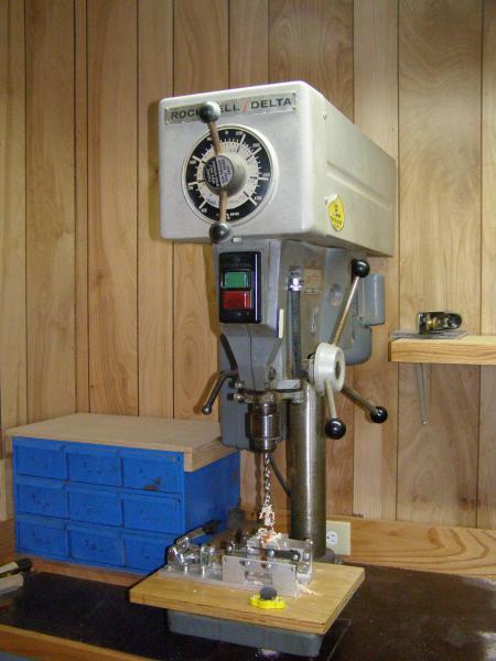

A lot has been said about what method to use in drilling blanks, drill press vs lathe. Both methods can end up in good results or unacceptable holes. I personally use a drill press.

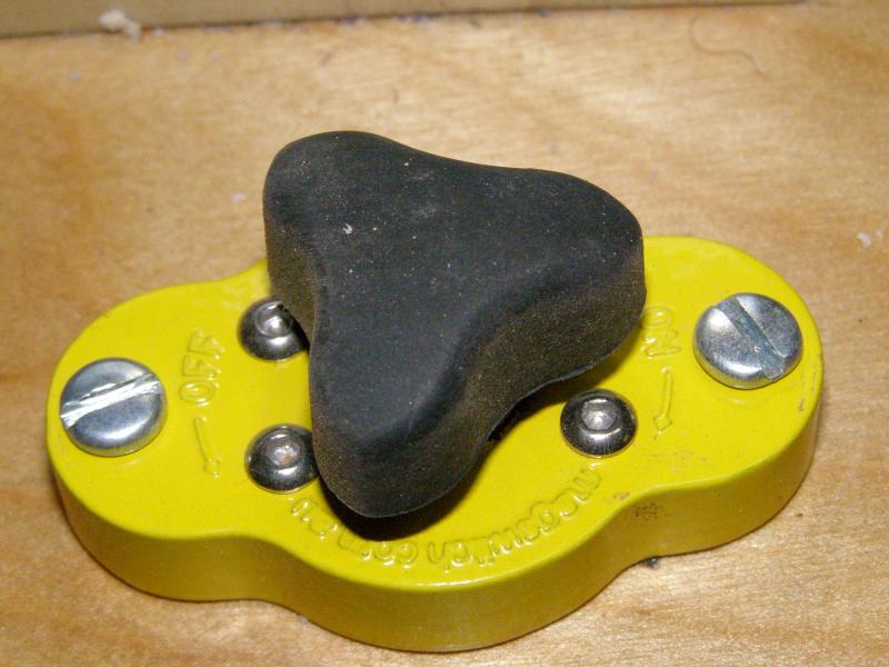

My drill press is a heavy 15" Delta/Rockwell purchased back in the 70's. It is heavy enough to not have viberation and powerful enough to not bog down. The table has been squared with the spindle. I have a vise purchased from Woodcraft mounted to a piece of plywood and Magswitch magnets holding everything to the drill press table. I use Colt brand drill bits. I take my time drilling, let the bit do the cutting without forcing. Drill 3/8" or so and clear hole. I use different spindle speeds for different materials. The lathe will cut nice holes, but this what I use and very seldom do I mess a hole up. Maybe good equipment and good shop practices have more to do with good holes than methods.

Colt parabolic bits do not require backing out the bit as they evacuate the chips. The mfg. recommends not backing them out and that has always worked for me. I confess that I do back out the last 1/2" on Inlace Acrylester blanks simply because they are so fragile at the bottom... even when taped.
I like your setup with the pen vise bolted to the table and prepositioned. I preset the fence and a stop jig and slide my vise into it. But yours is simpler and no doubt works great.

My drill press setup is almost identical to yours, except I use a Paul Hoffman vise rather than the vise you use. I keep it loaded with a 10" Colt five star heavy duty parabic 7 mm bit. I use this station for razor drilling (I don't really make slims anymore). The beauty of this set up is that it is very QUICK AND with the vise bypasses the necessity for center finding. With razor blanks the bit can still drift a bit without causing any real problems.

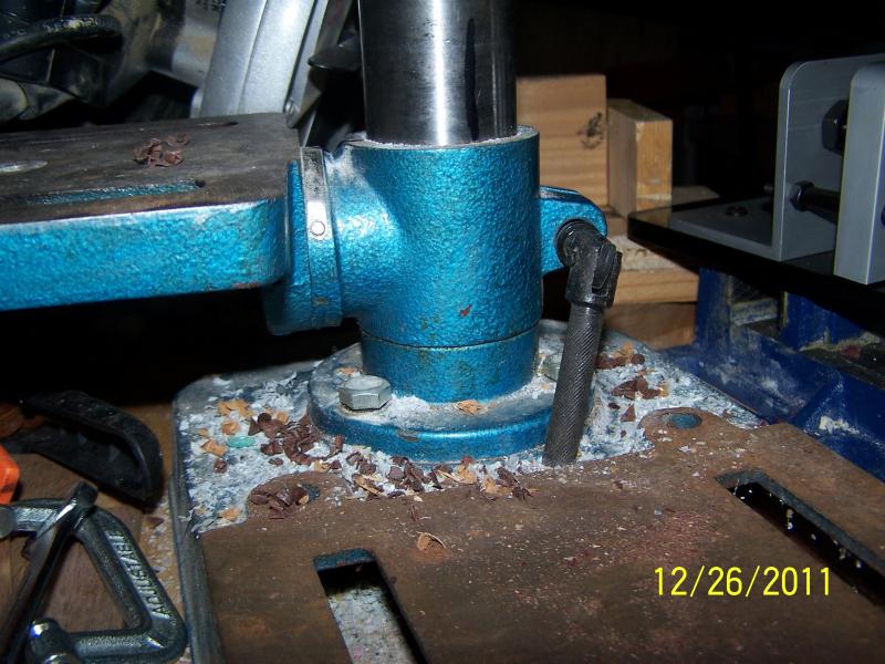

If you are very careful with squaring your DP table, vise, etc, with a 2" quill travel and slow speeds, you should be able to drill half way, then turn the blank upside down in the vise and still drill accurately.
Just be sure to put the same corners in the same sides of the vise when you flip it.

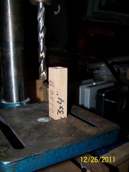

Now the holidays slowed now I got around to taking a picture of my drillpress. As you can see the bit is to big to fit the wood (Maybe need a shorter drill bit?). The table is maxed out (lowered) as in the other picture. I was wondering if flipping the table over would give me ant more room?
