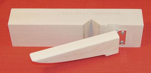

You can use a wooden clamp to hold your blank upright and straight. Look in the library for suggestions. You can also make a blank holder with two pieces of wood hinged together, with a matching notch cut into the middle to hold the blank. When it is closed it holds the blank securely with it in the middle. Put a board underneath to protect the drill press table. I used something like this in the beginning and it worked well.
how about this
