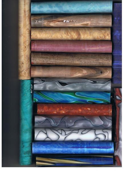

Well my drill press broke last nite so I dont have to worry about how im gonna drill blanks. Lathe it is. I got all the stuff I need to do it today and began by turning as many blanks as I could between center. It was a lot easier than turning them round on a mandrill. I figure what I will do is turn all my blanks round and then when it is time to make a pen, a lot of the work is already done. I also always buy some extra tubes for any pens im making so I guess I could make the sleeves and store them till I get a kit.
Also, turning the blanks on center before you make the pen gives you a much better idea of how the blank is gonna look so you can pick the best looking ones for the higher end kits.
I have attached a scan of the blanks I turned on center today.
The idea to do that and drill on the lathe was the best tip I've gotten so far. I feel like it has advanced my pen making somewhat.

Did someone TELL you to do it this way?

Ok Butch,
Did you come up with this on your own? Or did someone tell you to do it this way?
I have never read this procedure before and it looks brilliant!
(As I thought about it for the last few minutes, made me think of Eagle. IF someone had taught you HOW to do it, probably never would have come up with this BETTER way!!)
Thanks for the info - I WILL use it - on difficult blanks.
Bingo. Not only that, but this method gives you the chance to dare I say it...Practice with your tool of choice. This is how I learned what to and what not to do with the skew. You will see very quickly, the quilting, burl inclusions, spalting lines etc. that will make a very cool and visually interesting pen or a so-so pen.
You have a nice selection of blanks to start from. Good luck.
