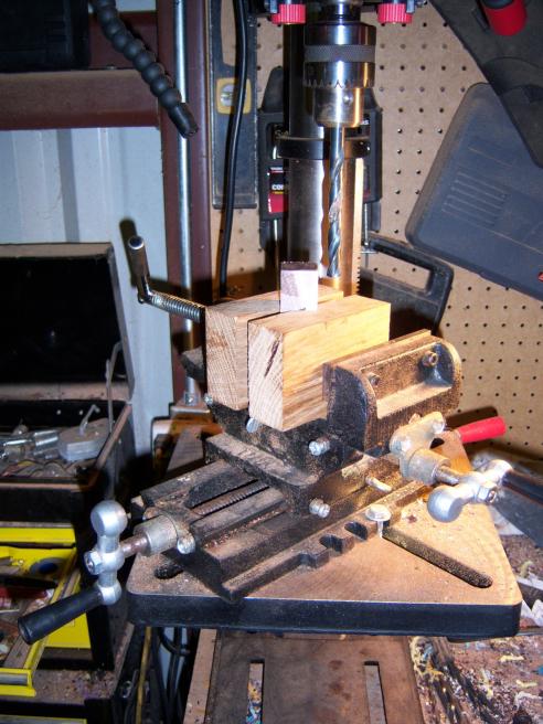

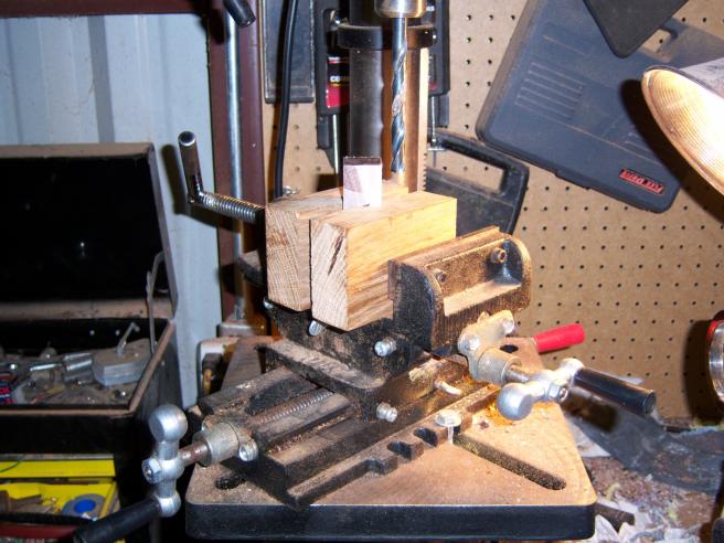

Rob when I bought my drill press i also purchased a cross slide vise for it.Makes everything so much simpler. If something isnt just right you just turn the handle a little more. Cut a block of wood(oak)sqaure then ripped it down the middle, then 45 it center of the middle on both sections and you have a blank vise. Also works well on round blanks.Bought the vise from harbor freight for abot $39.
