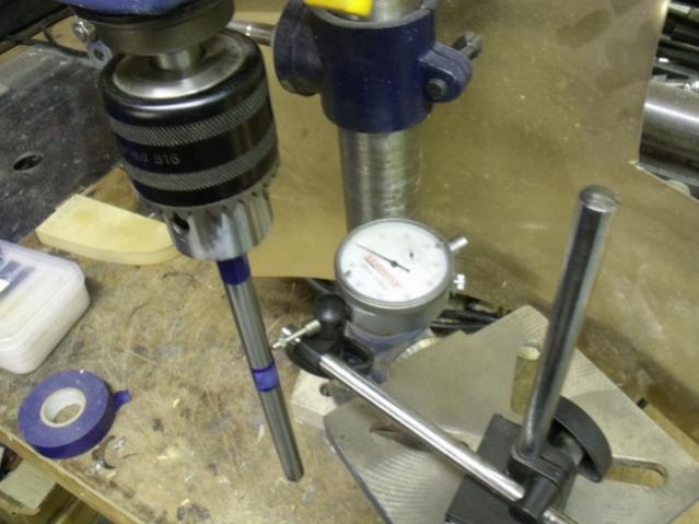

No problem. Excuse the poor pics, but I think they are good enough to demonstrate.
Look at the first pic. I have set up a dial indicator with a nice straight rod in the chuck. The quill is in it's highest position. If I rotate the chuck, the indicator barely moves. This means that the chuck is ok and the rod is pretty straight. It also means that there isn't much sloppiness in the quill while it's in it's highest position.
So now we would normally set the table square to this rod.

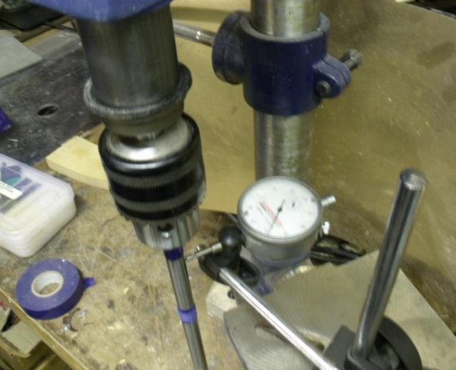

But now look at the second pic. I have lowered the quill to it's almost full travel. Only about 50mm on my cheap DP.
See how much the indicator has moved? You can move the indicator around the same point on the rod to find the worst movement. I just took pics of the first point I checked.
But this all means that either there is a lot of slop in my quill and / or the quill is not travelling parallel to it's own axis of rotation. Either way, the drill bit will follow the path of least resistance and drill an oval hole.
If we now need to raise the DP table to drill the hole deeper, then of course the hole just gets worse.
Why would it be oval? Imagine that the rod is a drill bit and the point where the dial indicator is, is the edge of the hole. When the drill bit is just in the material, the hole is nice and round but when the quill is extended, the side of the drill is still removing material by the amount the indicator moves at that side of the drill bit.
Now I can just hear the sceptics screaming that it's because it's a cheapy weapie drill press:biggrin: and this is true, but if someone had the money to buy a really good drill press, then they would also have the money to buy the tools to drill much more accurately on the lathe, so Wahhh!!!:biggrin:

LOL, gee thanks Butch!!!:redface: Actually that movement is about 0.3mm over 50mm so if your Ryobi is really less than that, then it isn't garbage. Just put it in a crate and send it to me. :tongue: Just imagine how nice my pens would be if I had a Ryobi!!!!:biggrin:
