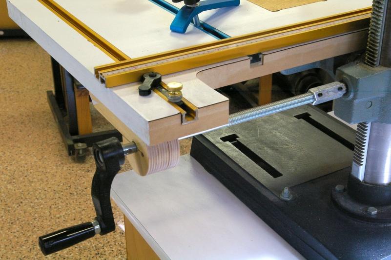

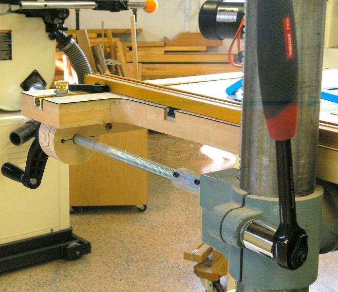

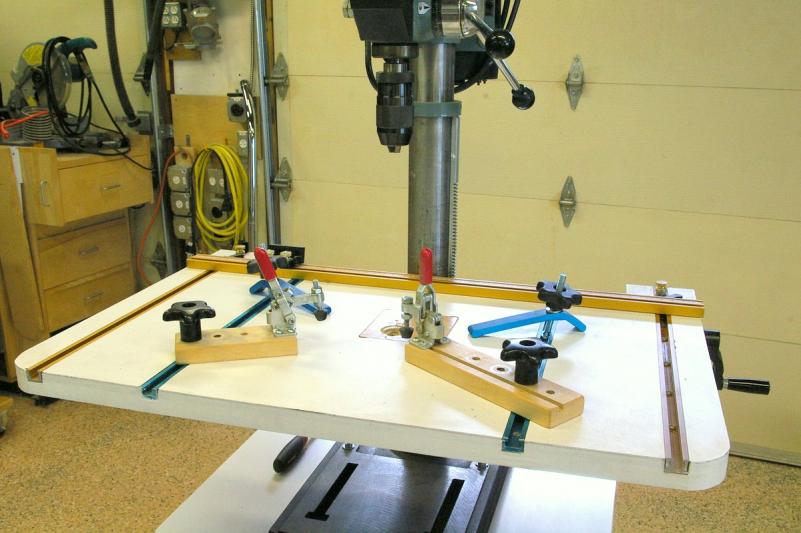

Here's my home made DP table with height crank adjustment extension. It works well. The extension shaft must be disengaged to tilt the table, but I do it so infrequently that it's not a big deal.

I had a few requests about the crank handle extension. I just used a carriage bolt of the desired length from my local hardware store and ground the head down to fit inside the crank handle bore. Simple and inexpensive. Hope that helps.
