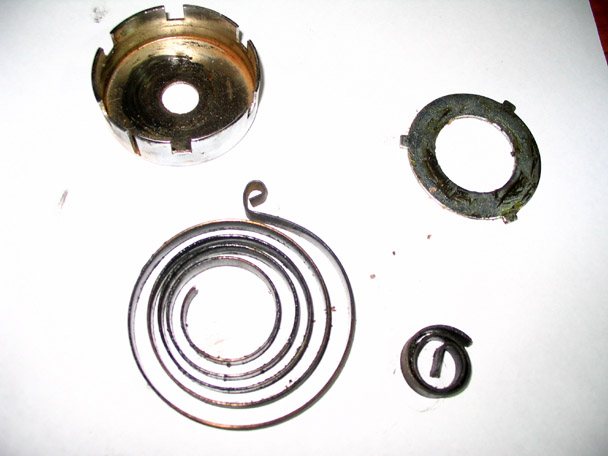

Well it happened yesterday morning---Murphy Law went to work in the shop---he has been hanging around since the 1st of January. The return spring on my 17 Floor model drill press snaped in half. I jumped on the phone---good news they have it in stock----along comes Murphy again----they will not be shipping this week because of inventory. So it looks like the big drill press is down for two weeks.
Still have my small table model that works fime for drilling pen blanks so life ain't all bad.
Here's what a broken spring looks like just because I know you have always wanted to see one.

Lee that might be a thought---heck it's just a small section from the center that is broke.
I will give it a try in the morning.

Springs are tricky critters. Heating spring steel is not generally advised as outcome can be bad. However, this is not a big safety issue with the DP. But I predict it won't work.

Been working on my old WT built in the 1950's for some odd 6 months now. I am not the one who came up with this trick, go check with the guys at OWWM's web site and you will find many more who have used this trick. Kinda hard to replace these when some of the companies have been gone for decades. [:D]
The heating is done only on the end, not the whole spring, not the best for it, but there will be more than enough length of the proper temper to retain the spring in it.
Well we are back to waiting on a spring----it almost worked---then it broke again---must be one of those Made in ROC things.
Heck it was worth a try--------thanks
